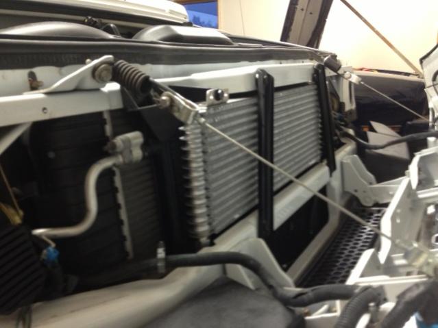

That is what i ended up doing was to fill it in the middle of the hot hatch mark so it will still have a little room to expand without being overfull. Here are some pics of the install. I enhanced the install thread i saw on here by removing the black plastic clip exposing the retainer clip holding the lines in the rad cooler. Better than trying to fit a sawzall or pipe cutter in there. I ended up capping the rad ports with a couple of 3/8 flare plugs i got from home depot. The lines already had a (bump) in them to hold the hose clamp in place so i did not need to make a stop bump with a flare tool. Also left the line on the driver side of the stock cooler alone and just used a 6 inch piece of hose to connect it to the new cooler. The pass side required a 12 inch hose. I cut the bottom p/s cooler bracket off the cooler as the p/s cooler is so little and light that it was not needed so as to make room for the new cooler. I used a 1/2 x 1/2 alum sq tube for the pass side top mount to make it as rigid as possible as appose to the supplied mounting strap in the tru cool kit. To keep a factory look and add some core support stability i removed the stock cooler brackets from the stock cooler and put them back on the front of the core support.

Great job!

Wow that's the size of a radiator on a compact car!!!
