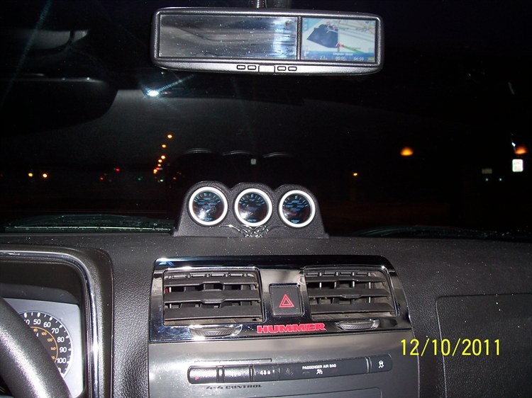

Old Jan 16, 2013 | 06:39 PM
samkelly's Avatar
Posts: 52
Default Gauge pod installed
Oil presure, tranny temp , exhaust temp.....AND yes....the rearview mirror is an AZENTEK SMARTMIRROR with GPS, BLUETOOTH, MAPS, NAVIGATION MEDIA PHOTO, MEDIA VIDEO on and on...great set up.
