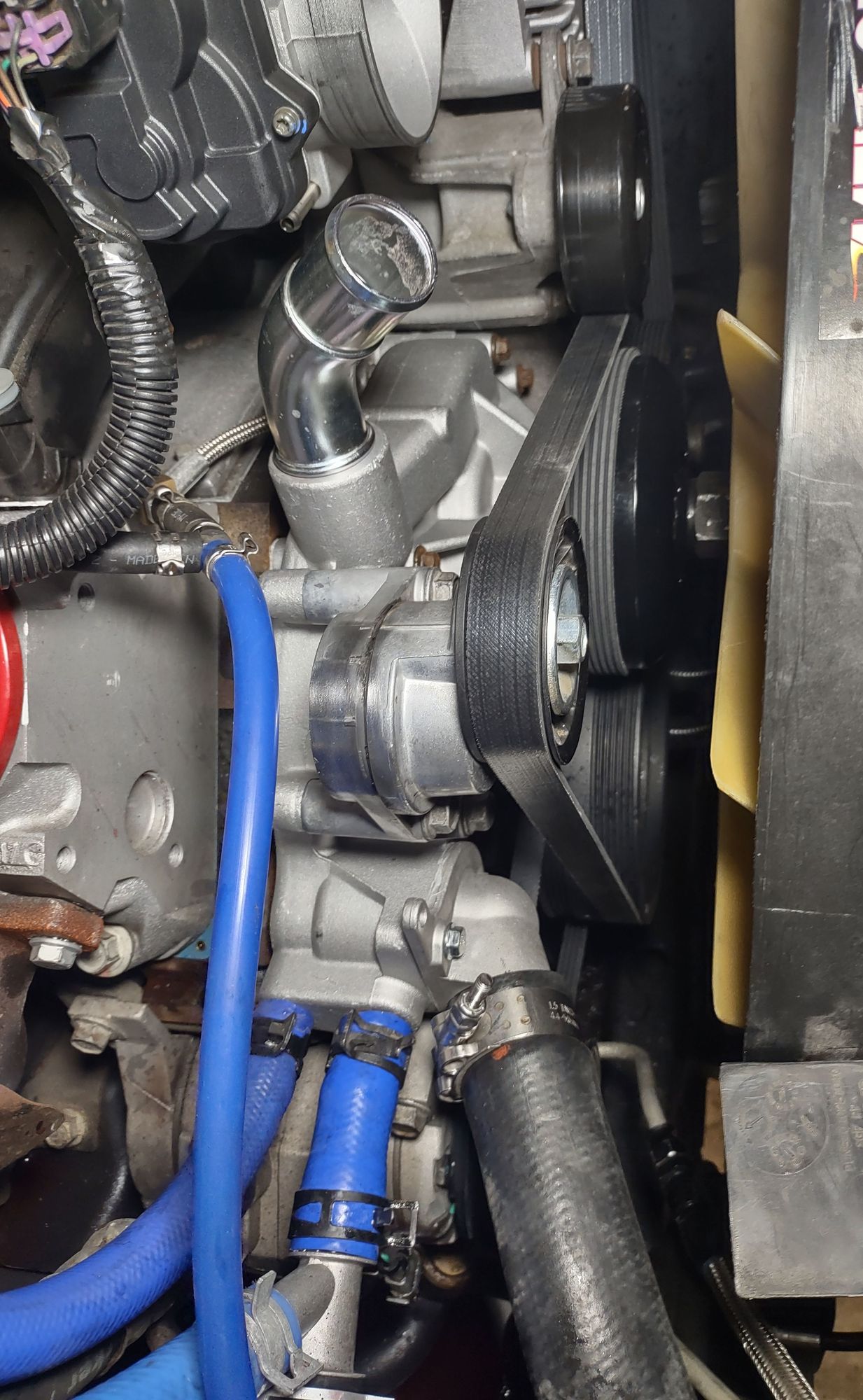

Went through this motor 18 months ago, everything new on the front of the motor. Chirping when accelerating, quiet when the RPMs drop. Did the usual, new AC and serpentine belt, tensioner and idler. Alternator was original so put a new AC Delco alternator on.
It was quiet for 2 or 3 days and then started up again. Drew a white line on the harmonic balancer and took it for a spirited drive. So much for a TRW harmonic balancer.... The outer part of it shifted about a quarter inch on a 20 minute drive. Also it was about 2 mm out of line with the power steering pulley. Bought a new genuine GM harmonic balancer, replace the front timing cover crankshaft seal just because.... Inspected the water pump pulley. Spin it normally by hand and it's quiet. Typical resistance. Spin it fast by hand and there's the squeak. Rocked the pulley and what do you know, about a millimeter of slop in the water pump bearing. (US Motor Works pump....never again)
