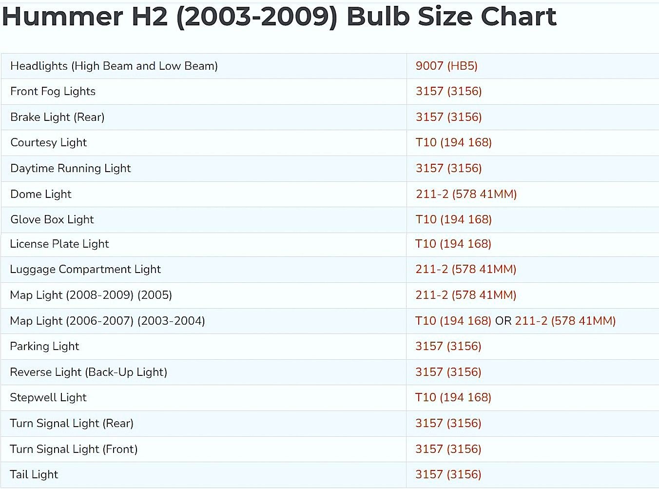

So My 2009 H2 Owner's Manual does not list this bulb forth Licence Plate. It list every bulb except that one. In small print it says contact your GM dealer for bulbs not listed in this manual. They list all the bulbs?????Except that one. WTF?? There are so many numbers this bulb could be. I had two small LED's under the plate on the hard HUMMER H2 tire cover under the plate that one by one they went out. The original Licence plate BULB just went out so now I have no light on the rear plate light.
I am Now Fuzz bait. I just went on Amazon and plugged in my ride and bought some LED that goes into the original Bulb location. Also bought two more under plate LED's to replace the burned out ones. Made in China..............What the PITA is taking off the Tire cover to get to the original bulb location and wiring in these new under plate LED's. I don't feel like trying to pop off the chrome cover as those clips are a Pain.

Hummer H2 (2003-2009) Bulb Size Chart
Headlights (High Beam and Low Beam)
9007 (HB5)
Front Fog Lights
3157 (3156)
Brake Light (Rear)
3157 (3156)
Courtesy Light
T10 (194 168)
Daytime Running Light
3157 (3156)
Dome Light
211-2 (578 41MM)
Glove Box Light
T10 (194 168)
License Plate Light
T10 (194 168)
Luggage Compartment Light
211-2 (578 41MM)
Map Light (2008-2009) (2005)
211-2 (578 41MM)
Map Light (2006-2007) (2003-2004)
T10 (194 168) OR 211-2 (578 41MM)
Parking Light
3157 (3156)
Reverse Light (Back-Up Light)
3157 (3156)
Stepwell Light
T10 (194 168)
Turn Signal Light (Rear)
3157 (3156)
Turn Signal Light (Front)
3157 (3156)
Tail Light
3157 (3156)

THanks Z Man for taking the time to research that 194 number for me. I googled my butt off trying to find that #. Still have no clue why the 2009 H2 owners manual does not list the licence plate bulb??? Anyway receive the LED version today from Amazon a 194. So it is the correct number.
Thank You Again..HOO RAH!!
