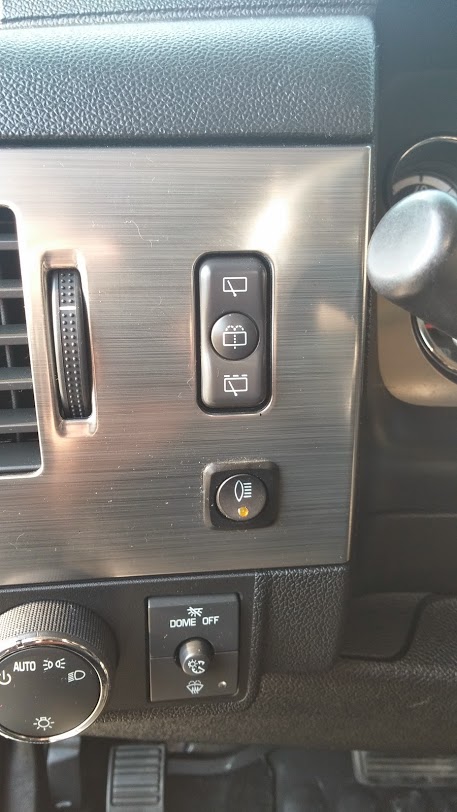

That circuit connects to a couple of relays under the dash that control the load for the power to the lights. On the other side of the relays was the switch and power wires that was mounted up by the interior map lights. I didn't want mine up there so I drilled a small hole just under the headlight switch for a more convenient location.

Here's what the switch looks like in ,my H2. When I activate it, the amber light still glows so I know it's still gettin' juice...
