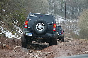

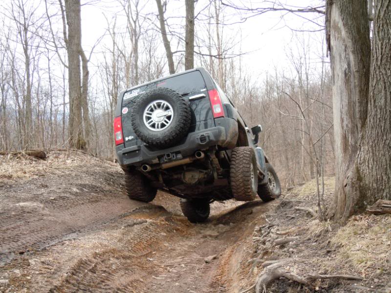

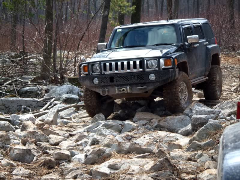

Leveling kit = complete waste of $$.
You need TIRES, some undercarriage protection, and some rock rails. The Adventure and Off Road packages get you a rear locker, plus a front locker in 2009+. Did I say TIRES? Yes, tires.
You could add more, but tires, rock rails and undercarriage protection are the basics.
The H3 can wheel with anything, don't need lift kits to do it. Lift kits are for kids.

Awesome pic, Air Doc! :
