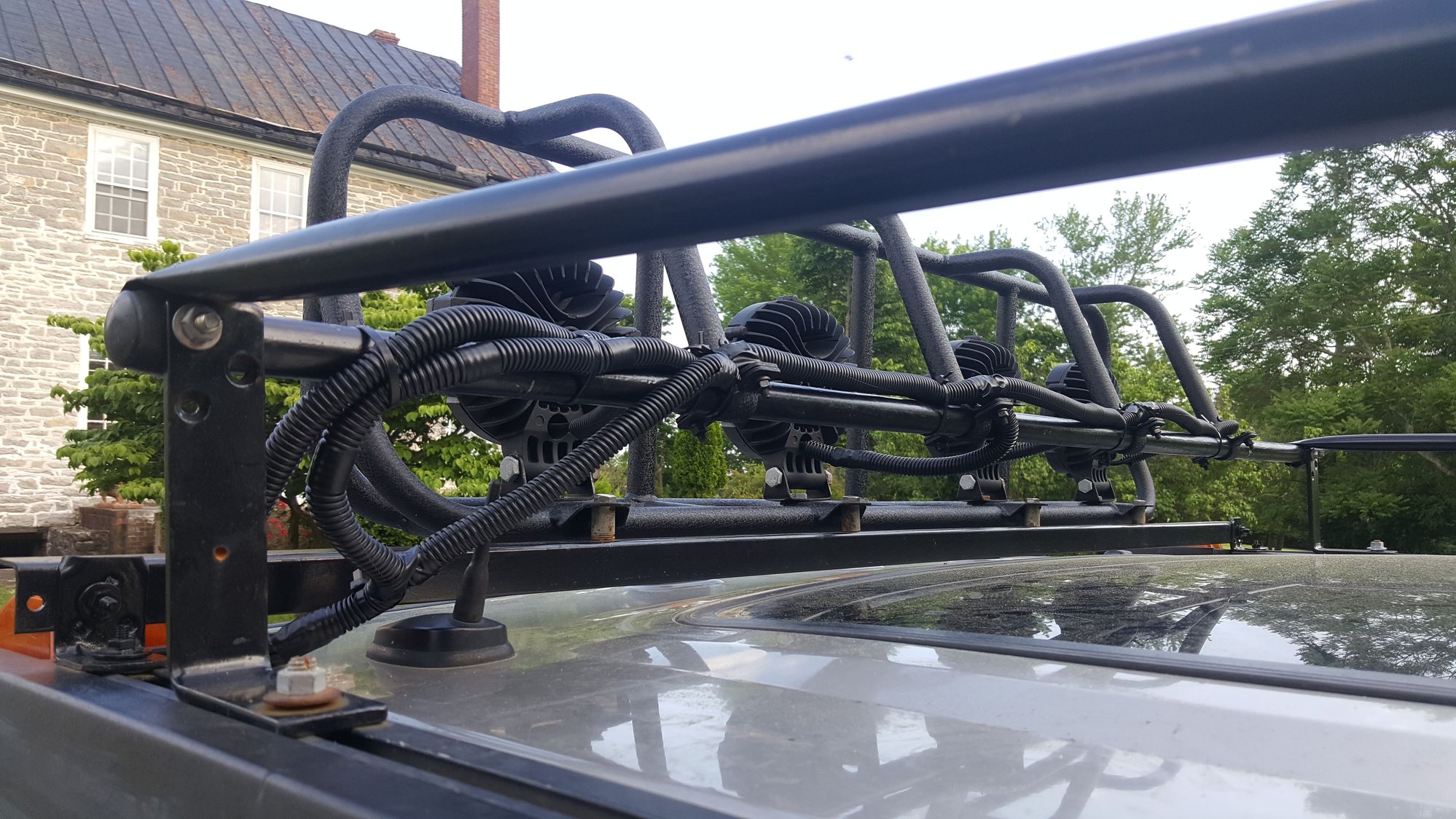

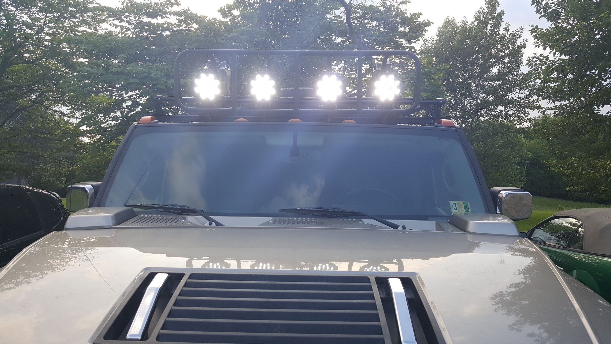

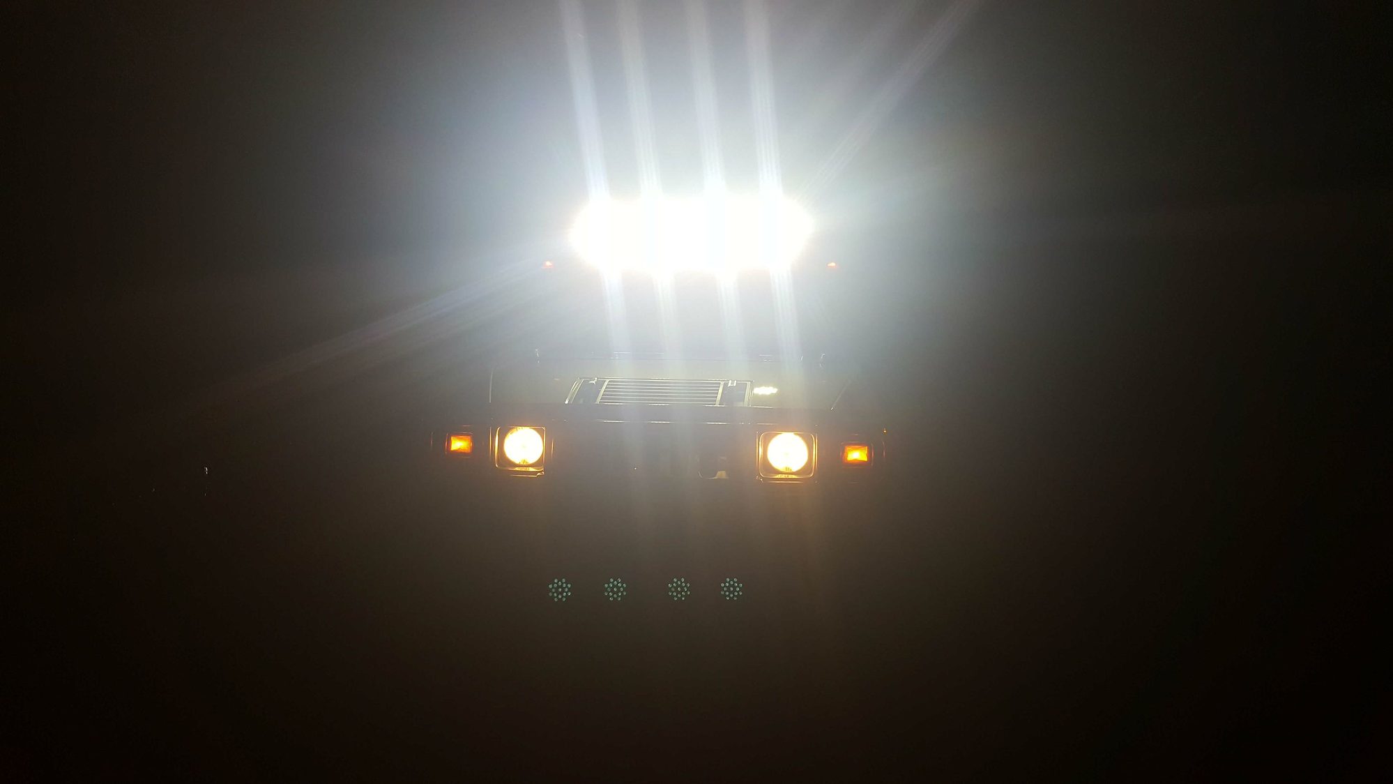

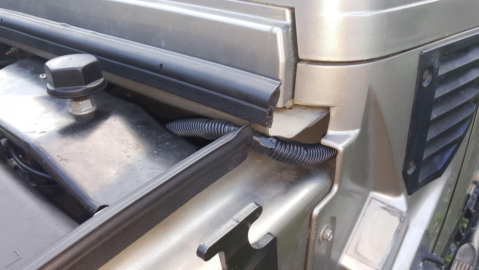

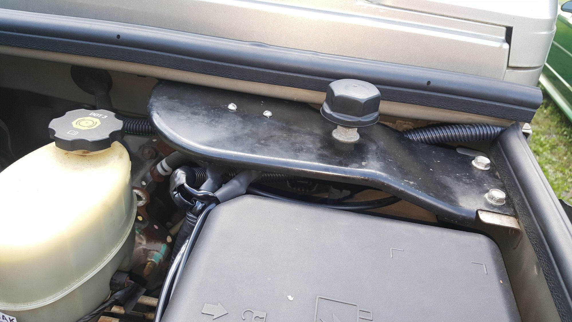

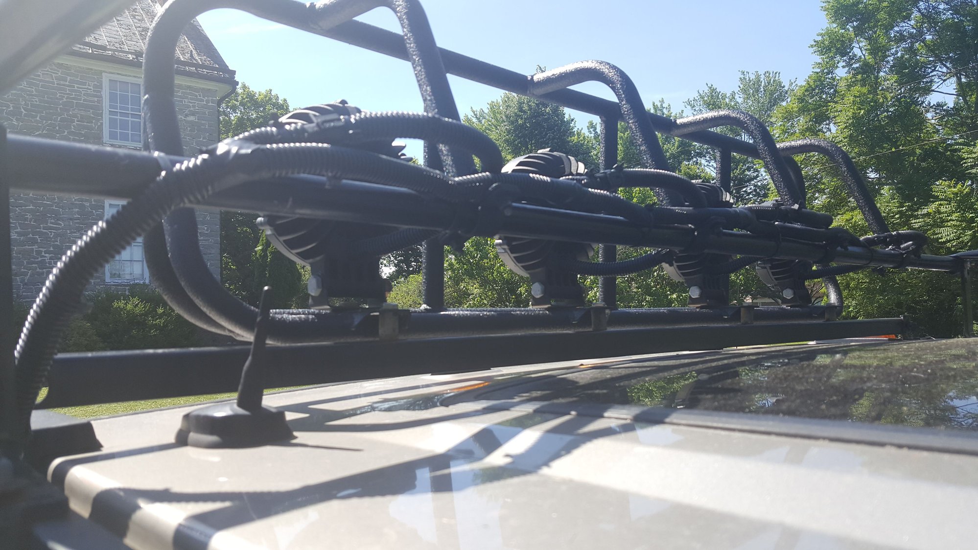

I finally finished this; it literally took me 8 hours, mostly because I had to re-silicone the marker light and my door seals. The wiring on top ended up looking like somewhat of a cluster F because I had to splice and some barely reached but it works so I'm happy. I ended up using mictuning harnesses from Amazon, and Rockford fosgate battery terminals. I mounted the relays underneath the hood rest brackets. Getting thru the firewall was actually way easier than I thought, just poked a hole thru with an ice pick, taped the wires to a coat hanger, lubed them with dish soap then pushed it thru. Here's some photos of how I ran things.

Completely redid the wiring on my roof and used waterproof connectors, looks a hell of a lot better and will be easier to replace something if i ever have a problem down the road
