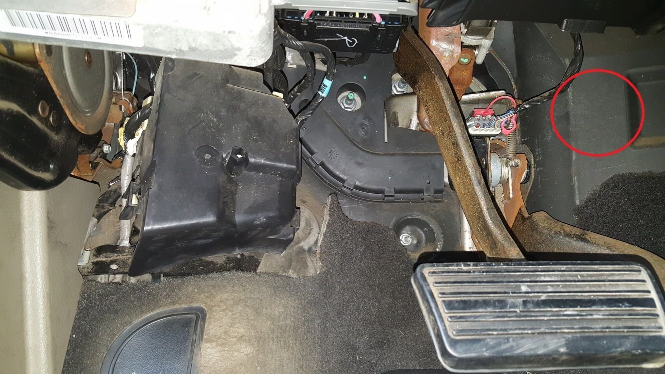

I will finally be hooking up my off road lights on my roof in a few weeks. I have been researching and looking at other threads in regards to getting through the firewall. See the attached photo... is drilling a hole in that spot still the best way to get into the cab from under the hood? For the wiring to get from the roof to the engine I plan to take the exterior a-pillar off and put the wires underneath it, then reattach the a-pillar panel over top. If anyone has done something similar could you be kind enough to upload photos of how you successfully ran your wires (both from the roof to the engine, and from the engine through the firewall)? Thanks!

I'm not sure drilling there was ever a "best" way. Seems like that would be a hard spot to get at as you are going to be down behind the engine there.
The "factory" dealer installed off road lights have the wires run through the factory wiring harness point on the firewall up higher and toward the outside. You can see it from under the hood near the brake booster.

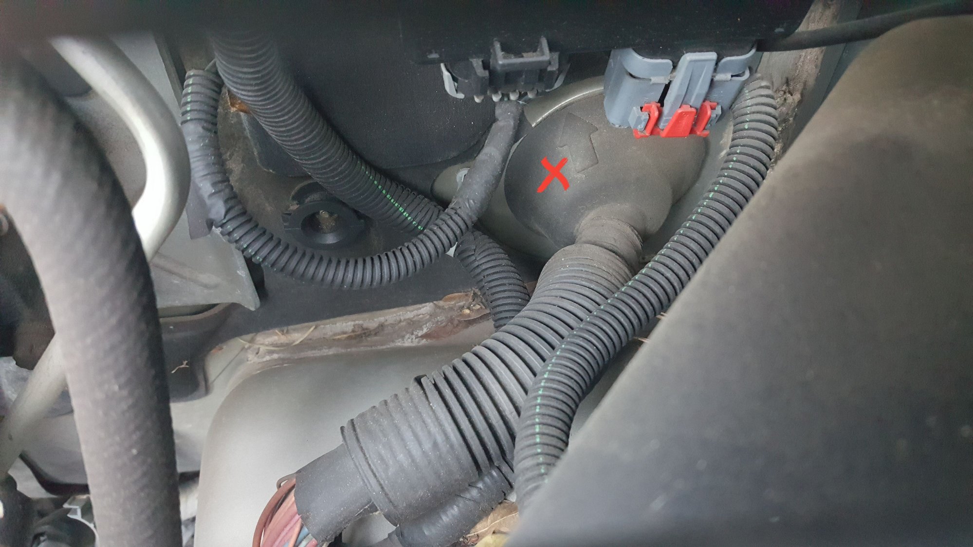

I have a massive bundle of wires which I ran through the firewall. I just made a slice through the inner and outer rubber grommets of the factory harness running through the firewall. It's towards the upper left when looking under the driver side dash. You'll see a big factory harness running through the firewall.
It is a pain to force a big bundle through those grommets but I didn't want to drill.

I have I would imagine close to a 3/4" of wiring running through the factory grommets next to the factory harness without issue. I wouldn't say I was overly careful when going through the grommets but I also stayed towards the outer edge of the grommets, away from the factory harness. I also did not drill the rubber but made slits with a new razor on the inside and outside grommets to help the wiring pass through.
It is definitely doable, just have to be careful.
Old May 21, 2018 | 01:13 PM
Yes, I would say that one should NOT attempt to drill through the factory harness grommet ever, under any circumstances with anything even resembling a drill or anything particularly sharp. I have poked wires through mine in both my GMC truck (pretty much identical harness and grommet location) and my H2 without any issue. I recommend staying toward the outer edges of it as LoJac mentioned. I have always used a quite long philips head screwdriver to poke the whole through it and then tape the wires to the end of the screwdriver and pull it back through with the wires.

It seems like drilling a new hole and going thru the factory grommet both have their pros and cons. I'm heavily leaning toward the factory grommet becuz I am not positive the switch wire is long enough to go the other way thru the area I'd have to drill from and reach. See the X's on the attached photos, my game plan is to slice thru that area, then run a metal coat hanger thru to feed the wires using electrical tape. Is that similar to what you did? Thanks!
