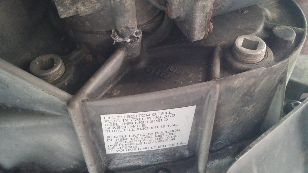

My 2006 requires removal of the speed sensor and add .25L thru that.(you can see the sticker instructions that they added). I haven't changed the fluid since I've owned it, but I'm planning to do it this week. Seems like there's lots of mixed feelings about what fluid to use.

"Manual Transmission fluid p/n #888861800 is currently available through GMSPO. Current and past model vehicles listed above (Models 2007 Hummer H3 and prior) with either a Manual Transmission or Transfer Case that required Dexron III should use the Manual Transmission and Transfer case fluid #88861800. This fluid is a direct replacement for Dexron III used in manual transmissions and transfer cases. DO NOT use Dexron VI in place of the #88861800 fluid in any manual transmission or transfer cases as a failure may result"

Im using Royal Purple Synchromax manual transmission fluid #01512. It is a direct replacement for the GM #88861800 according to Royal Purples lubricant cross reference chart. http://www.royalpurpleconsumer.com/a..._Reference.pdf
Running beautifully after 9k miles.
