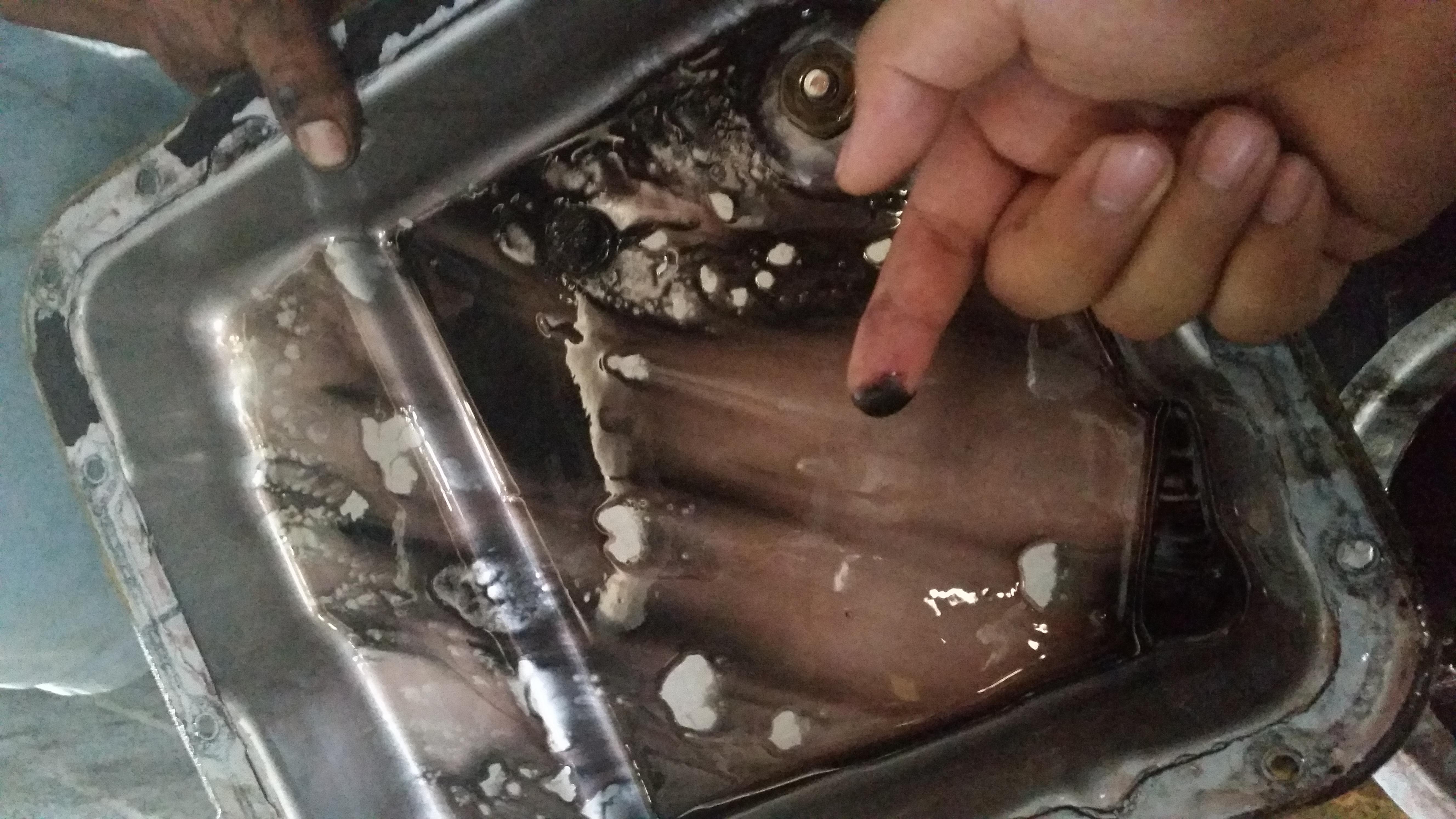

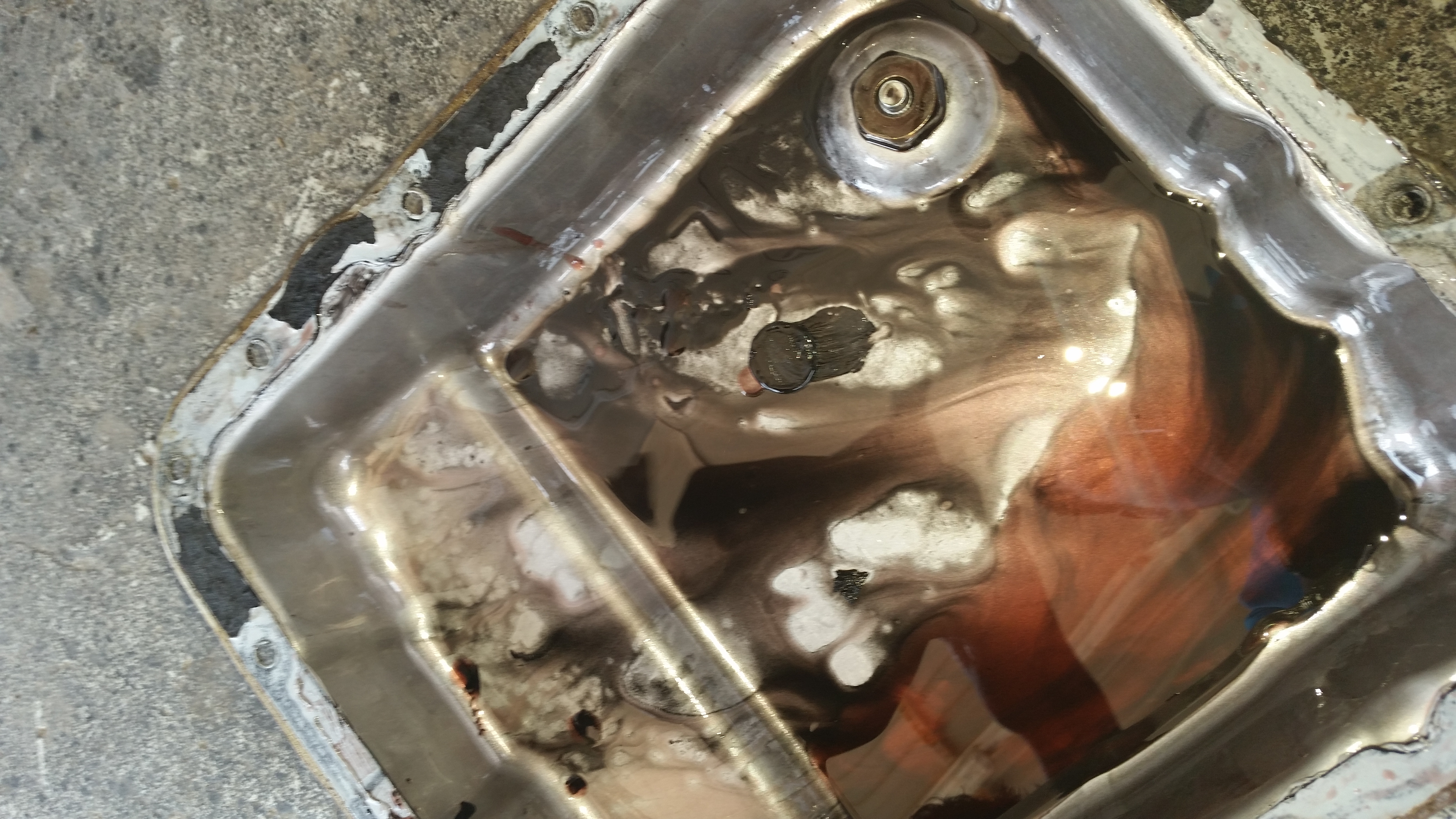

Can somebody point to me which sensor is connected to the gearbox? Like TCM,SOLENOID etc... location. A photo diagram will much appreciated.
Old Sep 20, 2015 | 07:44 AM
S Reynold Gudam's Avatar
Joined: Aug 2012
Posts: 160
Dropped the trans pan off today. I cant really see any shinny metal stuff in the oil but I can see there is like black carbon like stuff in the pan. See picture
Attached Thumbnails Only run on 1st and 2nd Gear-20150920_124422.jpg   Only run on 1st and 2nd Gear-20150920_124658.jpg
