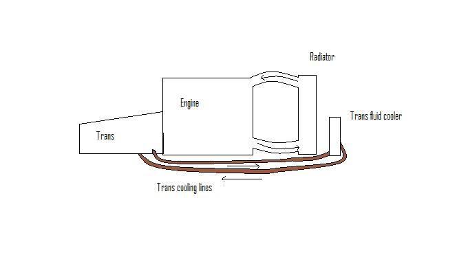

First question, yes. There is a mini radiator for the trans fluid(so to speak...) inside the normal raditor for the engine coolant. That mini raditaor or its lines within the normal raditaor can fail (fracture) causing the trans fluid to mix with the engine coolant (anti-freeze).
While this won't do much damage to the engine coolant, it can do substantial damage to the transmission. The transmission fluid is designed to lubricate as well as cool the trans and it doesn't take kindy to other fluids mixed in...read bad ju ju.
How will you know? Either you notice the fluid in your radiator has changed color (cause you checked it often...) or the trans starts to act up (which likely means substantial damage has already been incurred by the trans...again, bad ju ju)
Options? Looks like you could check your radiator fluid regularly and if you notice the color change, take to a trans shop or dealer for repairs...hopefully only fluid replacement and repair the leaking "mini radiator" in the normal radiator.
Oooooor, have an aftermarket trans cooler installed. Preferred method.
ANY transmission shop or even the dealer can install a trans cooler. It will be more efficient that the stock version and zero chance of the fluids mixing....
Original set-up....
Aftermarket trans cooler "by-passes" the stock radiator all together..as well as cool the trans fluid MUCH better than the stock unit. A real plus if towing...cool trans fluid is your friend....its not a big deal to cut into/splice new cooling lines to an aftermarket trans cooler.
