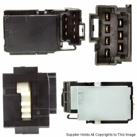

Wondering if u guys can help. My h2 is having some startup issues. I go turn the key to on just prior to starting it and everything is good. I go to crank it and it acts like it wants to start but then it dies. The dash lights then start to flash on and off to the cadence of the door chime and exterior lights remain on. Turn the keys to off and pull them out, put them back in and turn it to the on position just before cranking and all is well then try to crank again and the light show happens again when the engine stalls.
Can someone tell or even better show me where the starter is?
How about the fuel pump to change it out? Can I go though the interior under the rear seats?

Also wife reported that the airbag light came on and she couldn't adjust the driver seat elevation but front back and all that worked.
What is the part I'm looking for?
1)http://www.autopartswarehouse.com/po...Qgd2FycmFudHku
Or 2) http://www.autopartswarehouse.com/po...QgMTUyNDI3NTQu

I dont think either of those two pictures look like the ignition switch you need.

I was wrong it looks like the first picture you posted.
