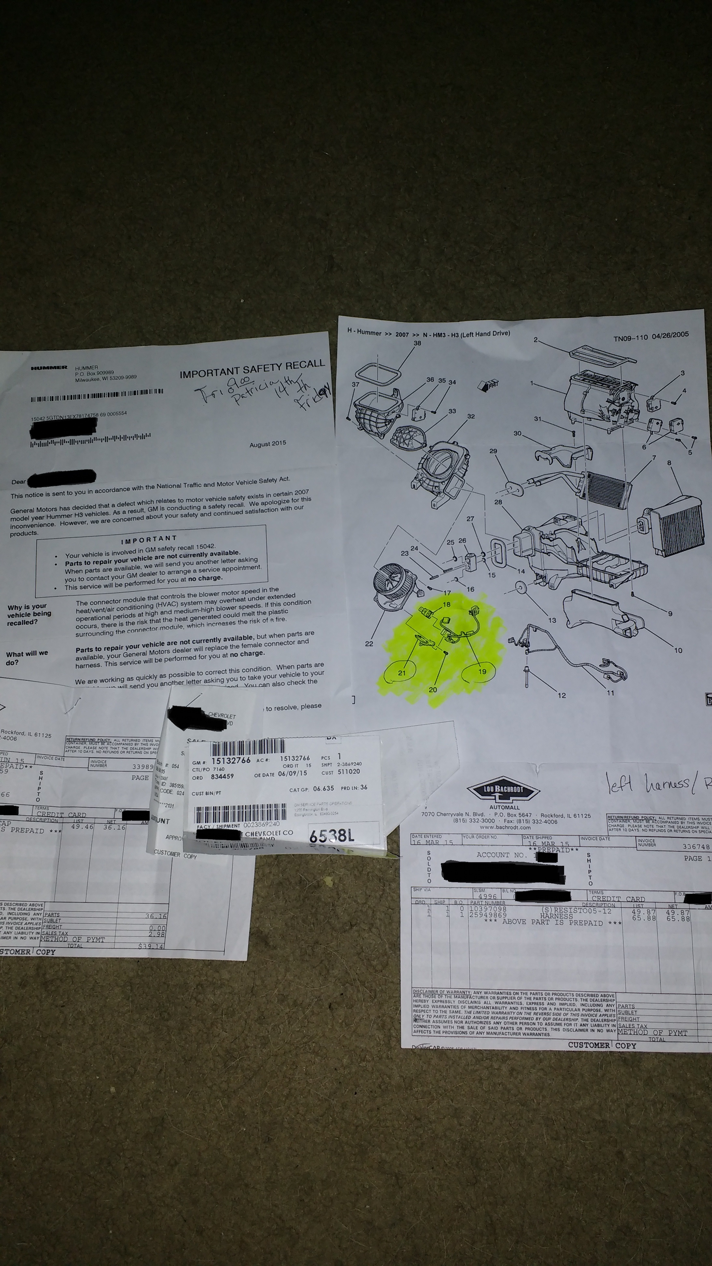

That's cool. But I'm not sure what relays you're talking about. The heater recall issue will replace the wiring harness and the heater fan control resistor; there's only one. And the DIY fix involves soldering the harness to the resistor to eliminate the loose connection which causes it to overheat and melt.

Oh, I apologize, it happened in March of 2015, also I'd like to include that I used incorrect vernacular in my description. The highlighted **** is what caught on fire, I had to then use a fire extinguisher, made by a non-General Motors company to put the fire out. Followed immediately by removal of the GM glove box door, and separate glove box compartment using my hand at first, then later after calming down from the initial shock of my truck catching on fire I proceed to remove the left over pieces that were not broken in my foolish haste of saving my damn truck, with a screwdriver. I then, cut out the burned and charred harness. I was able to figure out how to solder in new connectors, and add the new harness part number 25949869, and a resistor (not a relay as I originally wrongly informed everyone), part number 10397098. also highlighted in the picture. The recall notice I received was in August of last year. I certainly do apologize for not having the correct dates for you as well in my original post.
