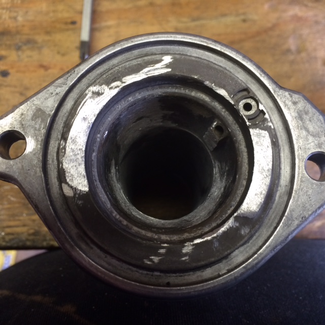

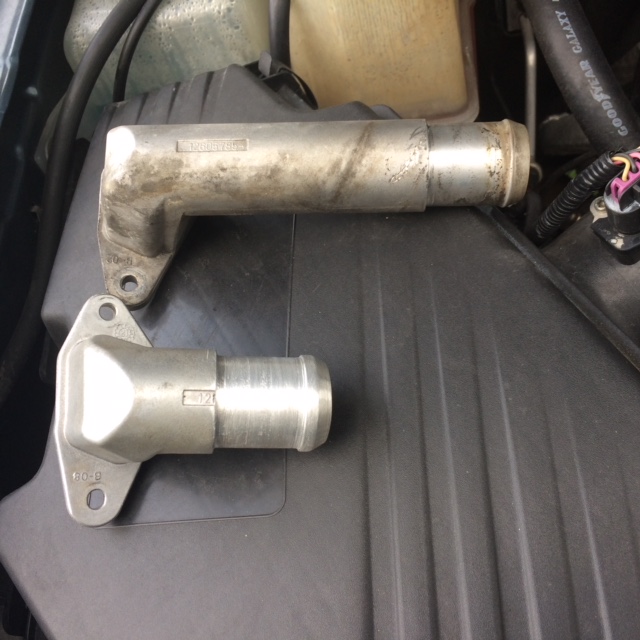

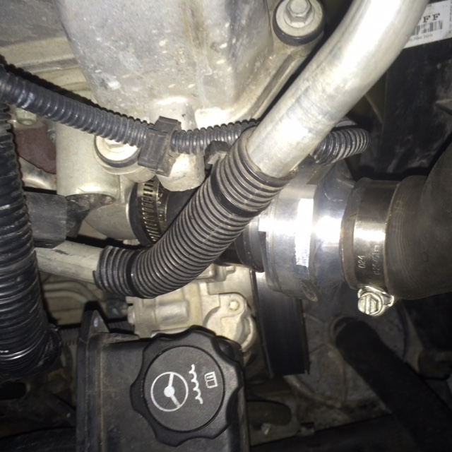

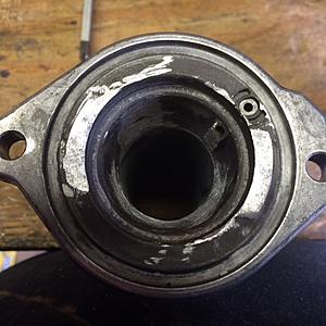

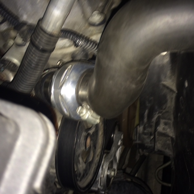

Long extension on 1/4 drive with 10mm.
I gutted the thermostat and reinstalled housing. Then I shortened the housing on top radiator hose at head. Get inline thermostat housing and install thermostat up top. Much easier to change out later. I ran a 180 thermostat in summer and 190 in winter.
