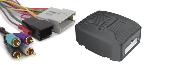

No sorry, I'm actually talking about the ground in the wiring harness behind your radio!
My wiring harness is a metra so it looks like this.
What you want to do is actually find the ground coming out of your radio, cut it before it goes into the harness, and put a terminal on it and ground it to the bar behind your radio.
If this doesn't fix your problem, it will at least clean up any slight alternator whine or static you may have.
However, I'm willing to bet this may fix your problem.
