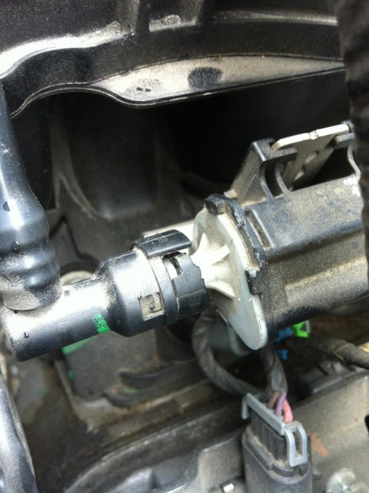

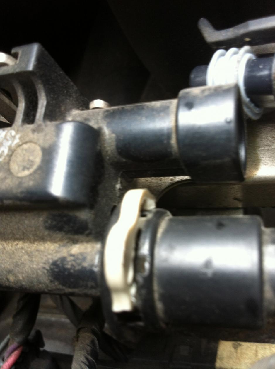

I am trying to remove and replace the existing purge valve and I am not sure how to remove the 2 hoses that are connected to the existing valve.
I have attached pictures of the connections, I am just looking for some input before I start forcing something and brake a clips
Thanks

Does anyone have the specific part number for this? In your picture Mgurogone it looks like only a small valve and everything I google comes up with a whole canister pt# Dorman 911-070. If I can find it I will update this post. Mahalo for all your support!
Update: Do not buy the entire unit as listed by the part number above. You only need the Canister Purge Valve (make your own hose if it cracks). Part number AcDelco 214-2147. The part is $28.00 Amazon vs $146.00 for the "kit" that includes the hose.
