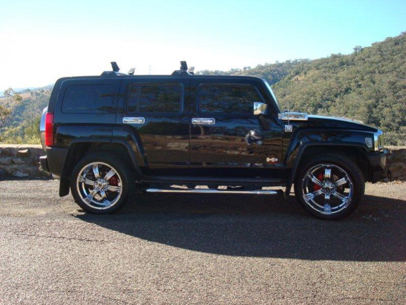

I have had 22" wheels with 305/40/22 tyres on my H3 for over 6 years and 70,000km, apart from a slight difference in ride quality they have been fine. I got 60,000 km out of the 1st set of tyres and replaced the disc rotors and pads at 70,000 km with cross drilled and slotted ones for looks.
I have no intension of taking my Hummer off road, it's just a great car to travel long distance in, we have pretty poor roads here in Australia and I have never damaged a rim due to the low profile tyres.
I have never had a problem stopping from speed and trust me here in western NSW I have to dodge Roos on a daily basis, wet weather grip has never been a problem either.
Cheers Stubbsy

Originally Posted by pearlerpicks
Stubbsy, this is a refreshing post...when you put the new wheels on did you do any modifications at the same time?
Thanks
I actually lowered mine 3" and fitted shorter shocks, my wife and young son were having trouble getting into the H3 being so high.
My H3 now handles sweet wet or dry.
