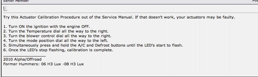

First thing to try is a basic reset, after that . . .
Hi guys, I did the basic reset and now it's working. Thanks so much.
