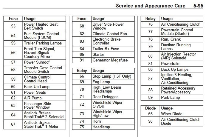

Interesting, the owner's manual online does not show a fscm relay, only fscm fuse?

Yes that is correct, it is not labeled for the fuel system but it is in fact a relay controlling power to the fpcu. I think in that chart it’s #66, I can confirm when I’m at home. You just jump
power from I think 35 to 80 across the relay and the fpcu gets power. I believe because this relay isn’t switching the alarm is cutting power to it for one reason or another. 🤷‍♀️The aftermarket alarm wiring is a bit of a mess. 👀

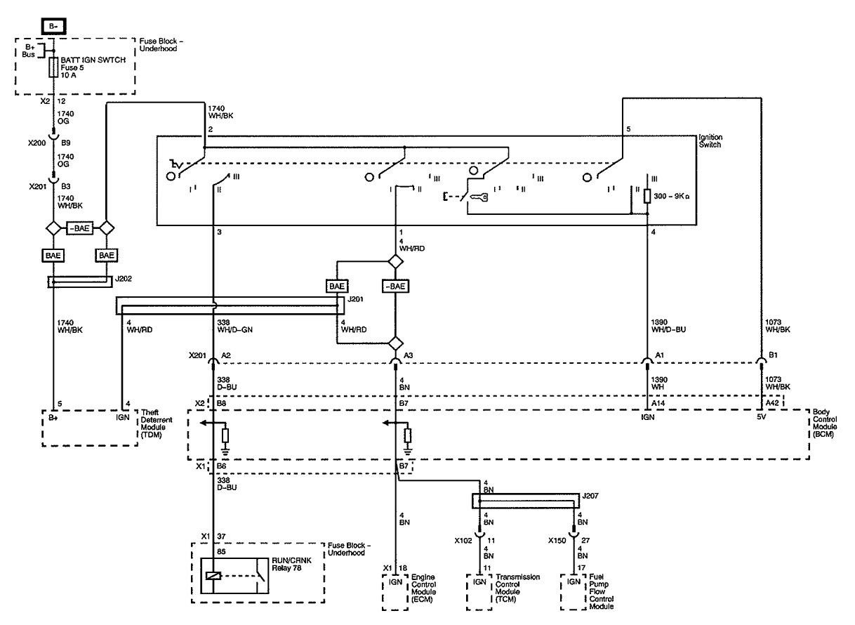

Hey does anyone have wiring diagrams? I am an electronic technician by trade and diagrams would be so helpful.😂

Posts: 9,014
Relay #78. Also check fuse #5.
