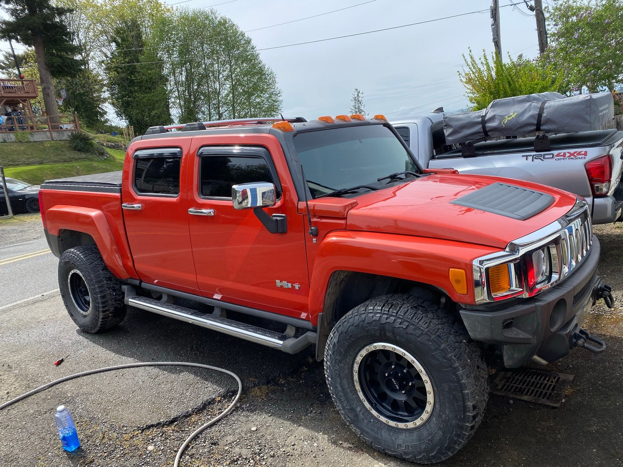

Ok so, status report! There isn’t anything wrong with this truck except that it isn’t getting any fuel. It starts up just fine with a little starter fluid, it drives itself forwards and backwards, and all other electronic items that have been tested all work. So far I need to buy wipers, one relay, I had to buy a battery this morning and an air filter, and I haven’t finished diagnosing why the pump isn’t running. Code U0109 is the only code being displayed. There is no pressure at the rail, and the pump is not turning on at all. There is power to the relay and the fuse, although the reference voltage at the relay is concerning low at .5 volts. If anyone knows anything about that being correct or not off the top of their head that would be helpful!
The truck also has an aftermarket alarm which could come into play with this issue. It has an Avital alarm with remote start that appears to be functioning properly but I can’t rule out it interfering.
The security light turns on with the key on and stays on.
Only evidence of flooding has been ever so slight corrosion present on few connectors, and the comically flooded drivers headlight. 😂

Little update: after I was done washing it it started one time, for around 45 seconds. Fuel pumps ran and when it died fuel was present at the rail. I think something with the alarm was disabling it but I haven’t gotten it to start again. Trouble shooting time is over for the days managed to get a wash done and wiped down the interior. I’ll be climbing in the mountains tomorrow and splitboarding so maybe I’ll get back to it on Monday. 🤙
