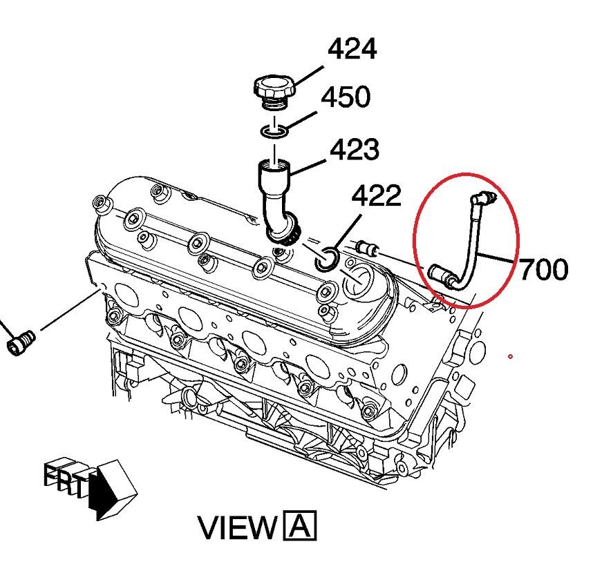

I posted the part number above. Fresh air PCV tube, goes to cai resonator hole you have covered with tape.
I said thank you for the part number and asked for photos of a stock setup because if you see the new photo they tapped a fitting and ran a line where it shouldn’t go, but thanks I figured out the stock configuration early. Idk why the dumbass taped and tapped a new fitting. 🤷‍♀️

As I stated above, remove the fuel in the tank and start fresh! Same when you put your lawnmower away for the winter.
Make sure to secure that pcv hose in the proper place!
