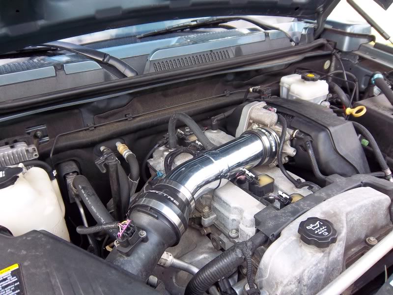

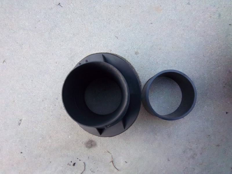

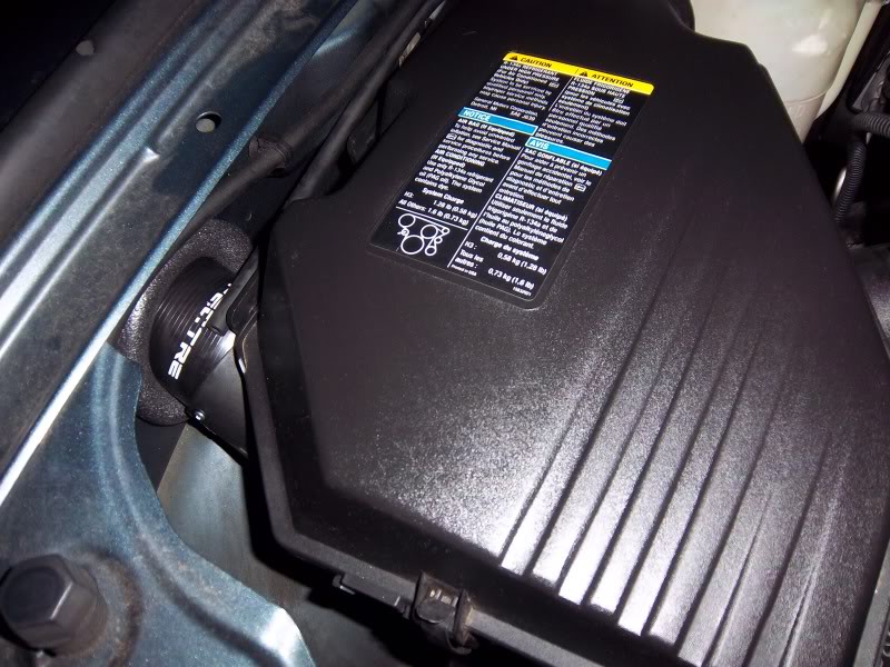

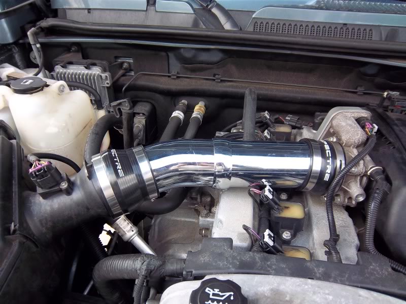

Firstly, I already had the Spectre air filter installed so I got all the parts needed for about $45. As c3rolling stated, The 4"-3" adapter on the MAF sensor is way too large. But I found that if I just kept tightening the clamp down I could get a seal. Also as he stated, the stock robber boot from the throttle body to the straight pipe was also too large and with the clamp all the way down it still did not seal. Not sure what the original poster did to get his to seal but it just didn't work on my 07. I ended up using the 8711 3" adapter boot to make that connection. I just stretched one end of it up over the throttle body lip and clamped it and then clamped the other end on the straight pipe. You can see what I mean in the pictures. Now I have a good tight seal on both ends of the pipe.
As also noted, the 8711 is just almost too short to use for the fender well inlet. I did as the original poster did and got it as far into that seal as I can. I am sure it is fine but I will change it later to get something that will extend a little farther. I am not sure what model truck the original poster had but on my 07 the stock air intake pipe is not all that much smaller than the Spectre part. He mentions something like 1.75". The stock pipe on my truck is almost 3" all the way through. I almost just put it back on.
All in all it was an easy install and hopefully should be a step in the right direction. I want to say I feel a little seat of the pants difference but I don't know if that is true or just my imagination. One thing I do think is certain is that I feel more vibration in the truck at idle. Not sure if this is somehow an affect of getting more air in or if it might be because I used the Spectre boot at the throttle body instead of the stock piece that would have more flex. Is it possible that an air intake can make a truck vibrate? The only other possible thing that worries me is the proximity of that second coil(?) connector. At first it was rubbing the intake pipe. I was able to get it moved away but only slightly - probably only 1/16th clearance. Hopefully that will not be an issue.
Not the best pics but hopefully you can see the details. Man, I really need to clean my engine compartment!

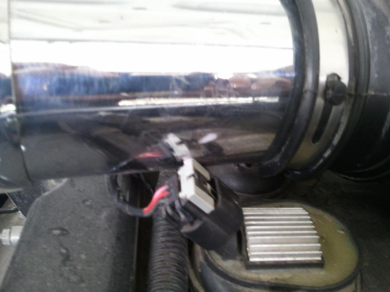

I did this mod a few months back and have been very happy with the results. Smoother shifting, more pull up hills, slight bit peppier, and sounds like it breathes freely now. I haven't noticed excessive vibration...the stock setup vibrates at the throttle body as well ive noticed. As for mpg, I've noticed a slight increase, maybe .5-1mpg. BUT, I do feel there may be better fitting parts for this project...the 4-3" coupler is way too big on the 4" side for the crappy clamp it comes with....I had to buy a good 4" clamp so I could really crank it down. A longer coupler at the fender would help, and the tubing does come TOO close to the coil pack as stated earlier. See pic down below to see how the coil pack started rubbing a hole into the tube...the white spot to the right of the coil pack is the deep gouge the rubbing created....it almost broke thru. I repositioned the tube for now...but its still gonna rub.
It seems like a hokie setup to me right now, but it works awesome....so I'll just keep an eye on it for now. But i would worry more if I did some hard off roading because of that coil pack interference.
