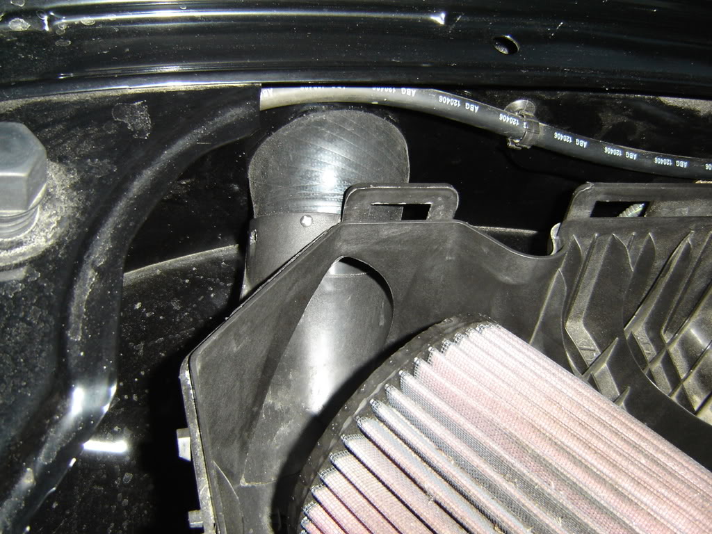

Doc, I have a question regarding your Air Doc system, or probably about just any. From the pictures you posted I see that the diameter of the pipe that you use is pretty much the same as the one that is currently there. The only difference I really see is that it is made out of metal.
How can it increase the air intake if the air supply hole in the air filter box is still the same ? Is there something in the pipe that increases the suction?
edit..... I was reading your website info and I now see that the snorkle is also replaced. Is your hose larger than the stock also ? I see a drill bit will be needed ? does that mean i have to drill..... I always feel ackward when any kind of drilling needs to be done on the car, especially engine parts :/
Yes, our replacement air filter box inlet snorkel is larger diameter than stock......... and funnel shaped to form the intake charge and increase flow.
Drilling is minimal and does not prevent you from placing the stock intake back on at lease end or when selling. One 1/8" hole will be drilled through the flange of the air filter box inlet and then a #6 SS Pan head screw is put through that hole to anchor the inlet snorkel. Looks like this when you are done...... see the one little tiny screw head.

That does look simple enough I guess..... it does seem like the K&N filter you have (if I am not mistaken) is almost as big/or the same as my Green Filter ?
