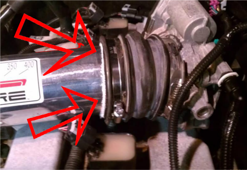

Sat. morning started the project. Well the first issue was trying to get the 3" coupler to seat far enough into the side wall with the pipe insulation. This was tricky and I really thought that the couple needed to be at least 4" long. With this in mind I looked at my 2007 snorkel and measured the output going into the box and it was just under 3". So instead of trying to get this to actually fit into the insulation I just used the 07 snorkel which in reality both ends had and opening of about 3". Whey reinvent the wheel right. Next was the reducing boot that the filter output attaches and after studying that situation I thought it best to cut off and file down the indexing bump on the piece that has the mass sensor on it. The 07 mass sensor plugs in from the top and not the side. The couple is 4" to 3" and 4" is slightly larger than the piece it has to fit on but when it is tightened down it is a good fit. Ok two hours has gone by trying to make decisions and really think this out. I am glad that I had a reducer left over from some part but it came in handy when it came time to slip it into the boot going to the carb. On an 07 the boot is larger than the Spectre tube and the reducing ring from the coupler I think came in handy in order to make it a snug fit. Anyways it worked. By the way the Spectre tubes are made of chrome plastic. This is why it was under $80.00. Now it was time to drill the side whole for the breather port vent tube. Got the whole drilled and you need to make sure that it as clean and free from plastic chips from drilling so nothing can get sucked down the carb. This is very important! After drilling the whole out and choosing the right rubber groumet it probably took another hour to get the groumet and 1/2 tube into the hole that was just drilled. This part was frustrating but I finally got it in with the help of a small rubber mallet.
Now the valve cover was removed and a new hose added and started to line things up. PS look at the instructions for o rings. This took awhile until I actually looked at the instructions of joining the two pieces.
Got everything lined up and started to tighten thing down in place. No problem here. The only thing I did notice hear was that the stright Spectre piece going into the carb. boot come very close to the fuel injector connectors so I stuck a piece of thin rubber between the injector connector and the stright 6" Spectre piece. By now it is 3pm, time off for lunch and everything is tightened down and time for a test ride.
I did notice that the engine was a little louder with the rocker box cover off but also did notice a slightly louder sounding engine and a little better pickup from a dead stop. To early to tell if gas mileage improves. Also noticed a new vibration sound coming from the engine compartment when you are going from a stopped position but it goes away once you are driving. It looks great uner the hood. I will post some pictures tomorrow. If I can return the 3" coupler the project will have cost about $72.00. That is a great number for something like this. I would put about 1.5hrs on thinking about each step of your instructions and making sure it would work on my 07. Also on the 07 there is and additional breather filter (what ever) that comes into the airfilter box from the front. Not sure what this does but it did not show in the DIY project posted. I have to remember that 07 was when they went to the bigger engine. Any one have any recommends for a fuel chip.
