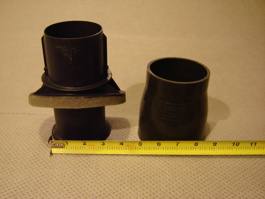

Next is probable the most helpful mod to your intake. Below is a photo of the factory snorkel. It is restricted from a three inch output to under an inch and three quarters coming into the box. The Air Doc does not address this issue, but Air Doc customers can use the mod for added benefits. Remember, Air raid is the same, so is the factory GM upgrade kit, & K&N and Pro Dry deal with heat issues. Volant is the only company to build a box that has more breathing ability, but dont' foget that cost? The Snorkel can be pulled from the factory air box using a flat head screwdriver and discarded.
Take the 3" coupler from your parts list and remove the ring clamps. There is also an inside reducer you will not need. The inlet for the air box is actually a bit oval and not perfectly round, so you will have to work with the coupler a little to seat it inside the opening. Make sure the coupler is no farther than about 1/4 of an inch inside the hole. By pushing it in to far you will end up with too short a tube to seat properly against the port and insulation on the fender wall. Next use the 2 short self tapping screws to fix the coupler to the air box.
Once you have mounted the coupler, you can reinstall the box. Remember to check you fitments as you want to keep hot air out and cool air coming in! This will open your actual intake from the reduced 1.75 inches to a full 3" inlet!
Not a bad DIY. Looks pretty good. Better than a bunch that I have seen before for sure!
Just wanted to point out, we DO and always have addressed what we refer to as the pie hole issue. Included in our H367. Our funnel shaped inlet snorkel (R) replaces the stock inlet and its lousy foam seal (L). Seals to the inner fender because its OD is ever so slightly larger than the inner fender hole ID.

Doc, thanks for getting back with us on the snorkel issue, our mistake. You have a great product, rock solid. Like you, we tend to play more than buy. Sometime it gets us in more trouble than good!
