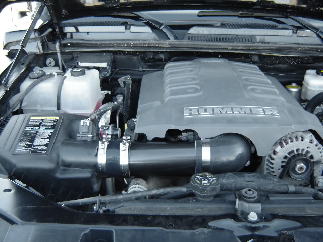

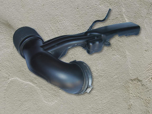

All Air Doc intakes come with outstanding directions.
With that being said, I was DOCs Alpha test mule. I have removed the "cowl cover" gosh like 12 times (seems like 100). It' is very simple.
Steps
1. Remove your oil fill cap
2. Gently pull up on the cover, there are a few rubber bushings under the cover on either side attached to the cover that sit on posts comming off your engine/intake.
3. Once those are lose and you can tilt the cover up...PUT THE OIL FILLER CAP BACK ON!(trust me and DOC on this one!)
4. While the cover is tilted up, gently pull forward (toward the grill) and the rear rubber/plastic hinge thingy (technical term) will release.
Please be very careful if you are doing this on a cold engine, very cold + plastic and rubber= broken plastic (trust me on this one)
The rest is a piece of cake, you won't believe the strange looking thing that lurks under the cover.
No wonder DOCs intake made such a difference!
PS I borrowed these pix from DOCs site, I don't think he would mind since they are of my stuff!
