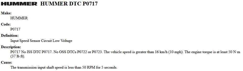

With code P0717 it means that PCM is not seeing any speed signal from the ISS. You can stop here now, and drive on, if code returns, go to pcm connector/contacts.

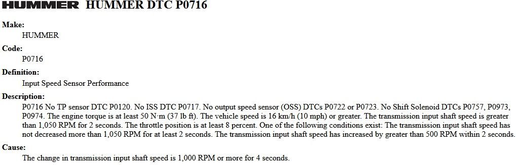

The code back another
it haven’t been since my last post but this morning I started the hummer , it’s 45 degrees outside and the check engine light was on. I checked for stores codes and it was the stupid p0716 instead The hummer still drive fine . Should I clean the connection at the pcm and grease then? Or what else should I do ?

so that p0716 was for the other speed sensor, I changed it and it went away but today I was driving the hummer and p0717 came back on and I cleared it . What else you recommend so it doesn’t keep coming back

Both codes point to the ISS.
