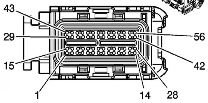

Look for the BROWN/WHITE where it enters the connector.
Here's a 56-way C1 pinout:

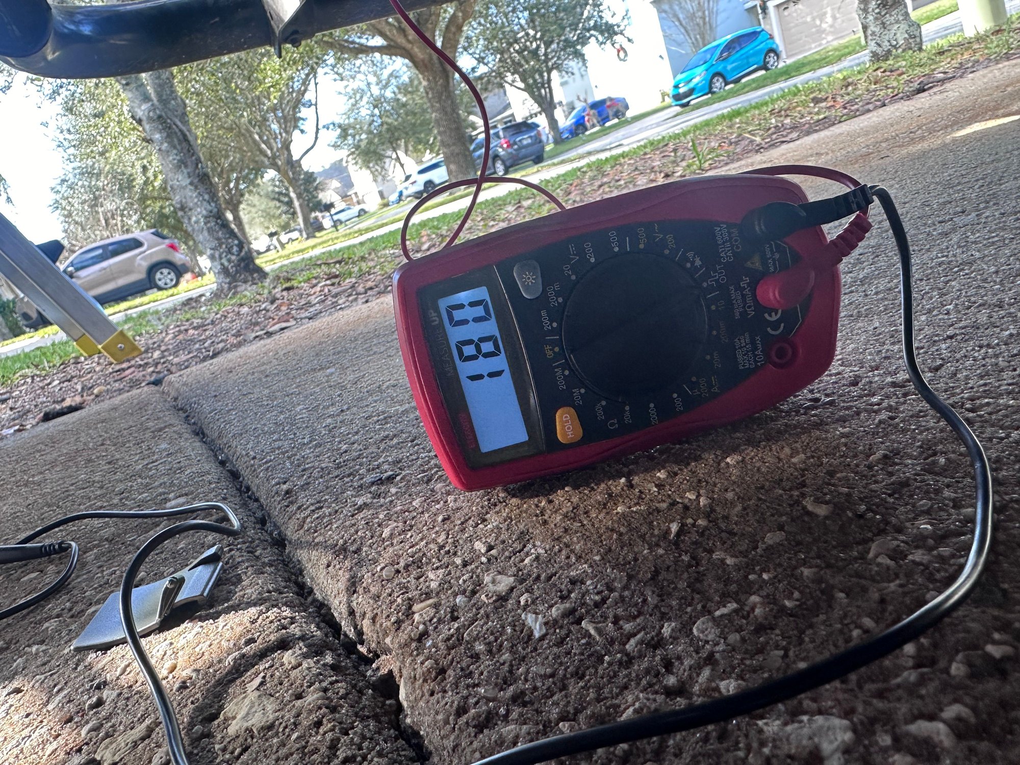

thank you I found it I checked the circle and the multimeter beeping so no shortage to the pcm
so so far 11.92V on E
now gonna check the square wave signals

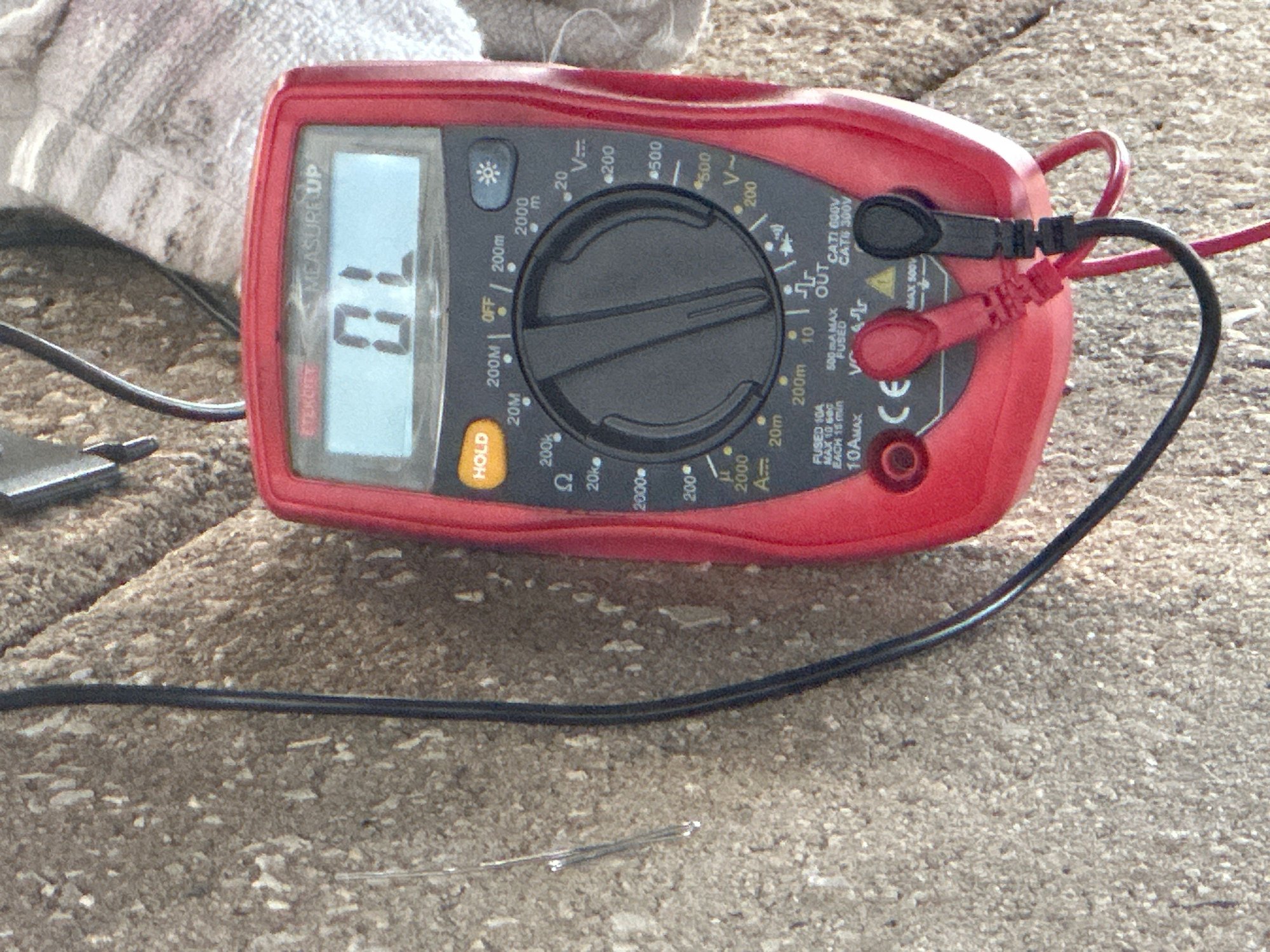

for the wave signals, when the engine is off I am getting signals , as soon I turn the ignition on or start the engine , I get no signals . Am I doing something wrong ? I backprobe and ground it to another ground

Dont check continuity with power on the circuit you may blow a fuse. Set meter to 20v and watch the volts fluctuate.

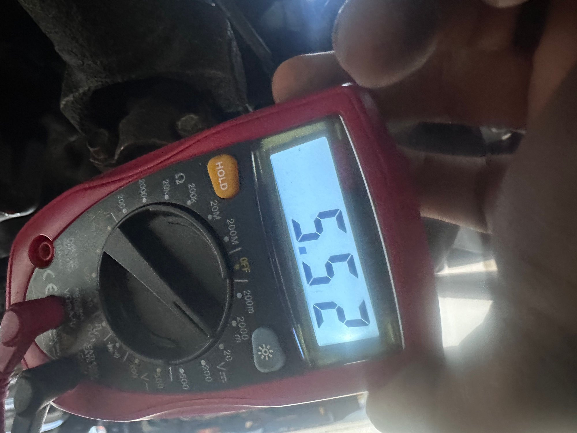

I checked I backprobed it and ground it and put it at 20v and started the engine it reading fluctuating 5.52v
