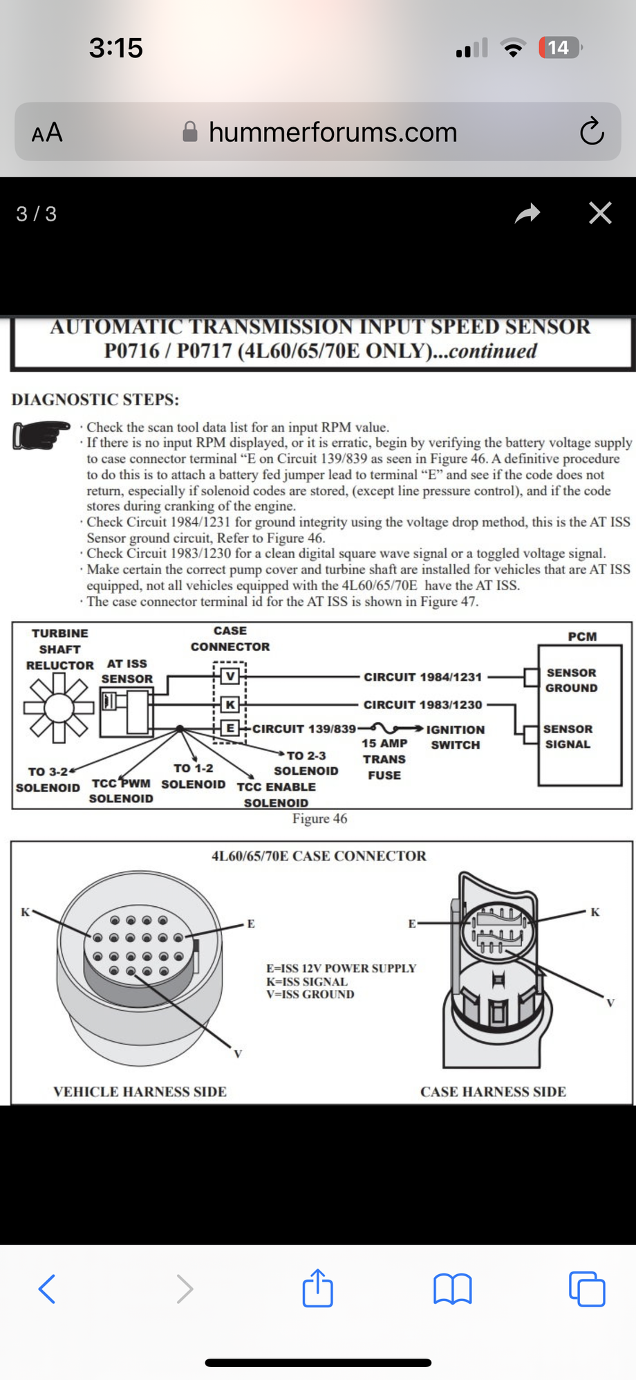

Input Speed Sensor Circuit Low Voltage
At the plug to the transmission, check for 12 volts on pin E Pink wire.
Ground on the pin V Light Blue.
Verify pin K Brown/White wire is not open or shorted back to the Powertrain Control Module (PCM) Blue connector pin 23.
If all the above is OK with everything plugged in, backprobe the Brown/White and check for square wave signal with the engine running.
If no signal is present, then replace the input speed sensor.
To replace the input speed sensor requires removal of the transmission and then removal of the front pump from the transmission assembly. GL

so the plug under the hummer just unplug it and put a red voltmeter to the E pink wire. And the black voltmeter to ground it on the B blue wire and I should read 12 volts . Now my question is do I do that while the engine is running or not? Also how do I know which one is E and B do you have a diagram?
as for the K brown white wire to check if not shortened to the pcm just basically trace where it goes and make sure it’s not cut or short?
lastly what you mean by backpeobe the brown and white and check for square wave signals. How to do that?
thanks alot hummerz

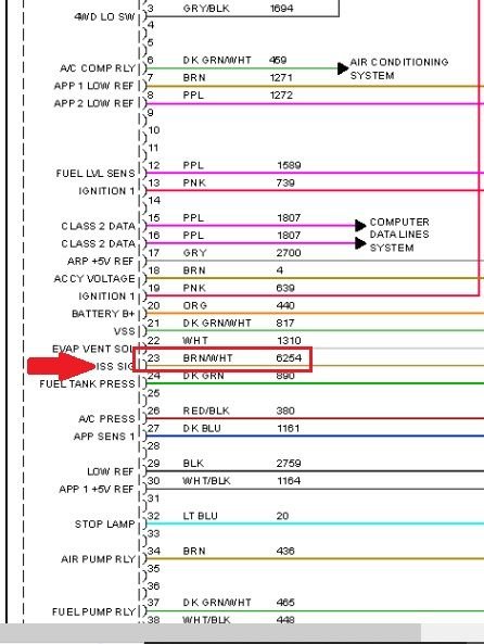

I found the diagram and to check for waves signals , can I ground that with the light blue as well? Or do I have to ground it somewhere else ?
Old Dec 20, 2023 | 05:52 PM
Any ground to back probe check signal on K Brown/White with engine> running.

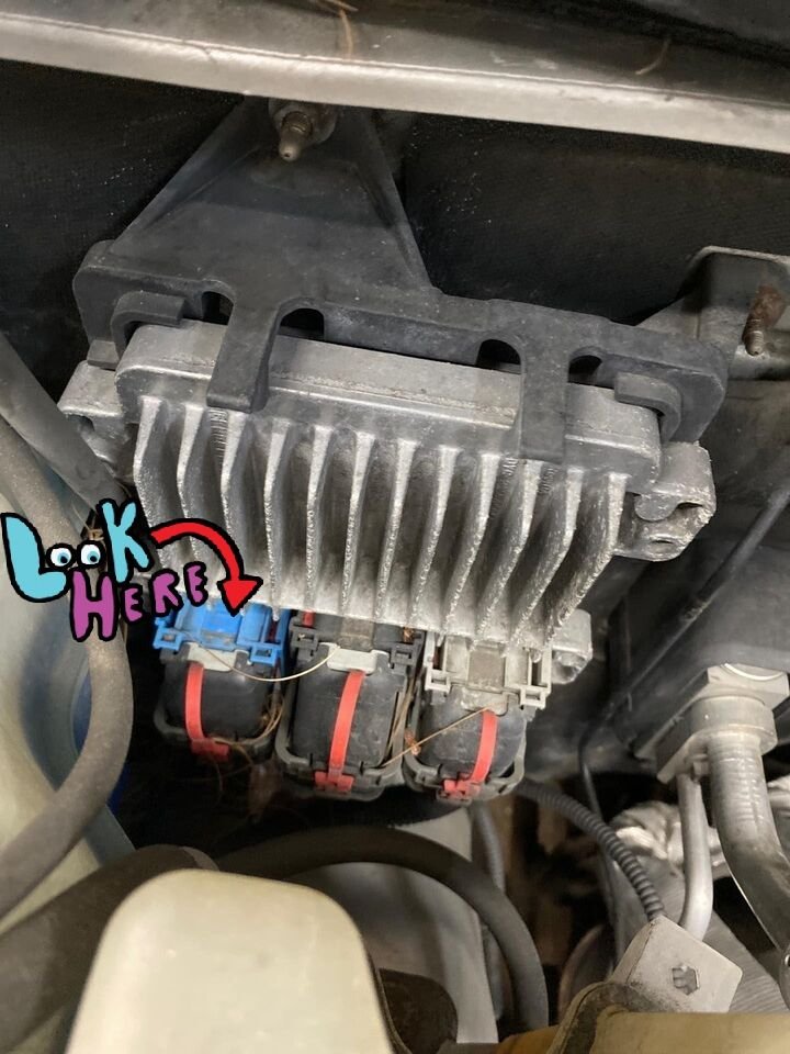

As for checking to see if the brown and white wire not shortened all the way to pin 23. What’s the easiest way to check it and where is PIN number 23?
Old Dec 21, 2023 | 09:02 AM
Originally Posted by NFS
thank you hummerz I got paper clips that will do the trick too. I will check all that today and I will ground that brown white wire to the light blue since the light blue is ground and check for wave signals once I check everything else
J1-Blue connector pcm, Brown/White, continuity test connector pin to connector pin with both connectors disconnected, start at 3:30:

thank you a lot that’s a lot of helpful information to check for any shortage plug one end to the pin 23 and the other end to pin K? My question is they are really far apart how can you get ur multimeter to plug on one end from the engine pay to the other end under where the harness is?
can I just use a regular long wire with a paper clip to k and attach the other end to the multimeter it will still transmit signals and such right ?
Old Dec 21, 2023 | 09:56 AM
Not that far apart, just use a jumper wire on 1 end or get another> test lead to extend 1 end.
