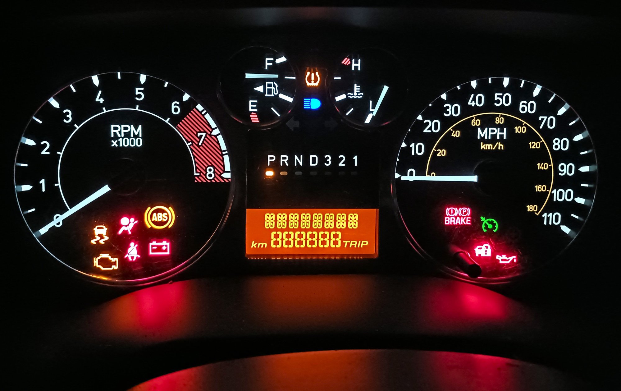

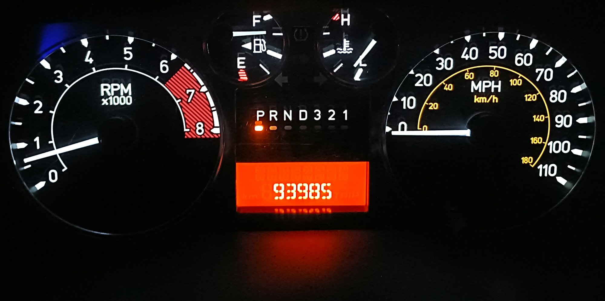

My '07 still has the OEM FACTORY INSTALLED BCM & PCM!
I installed my current tires & TPMSS in early 2014. This is all I have seen on my instrument cluster after 10+yrs:
Key on(shows all warning lights) & Startup-idling(no warning lights)
