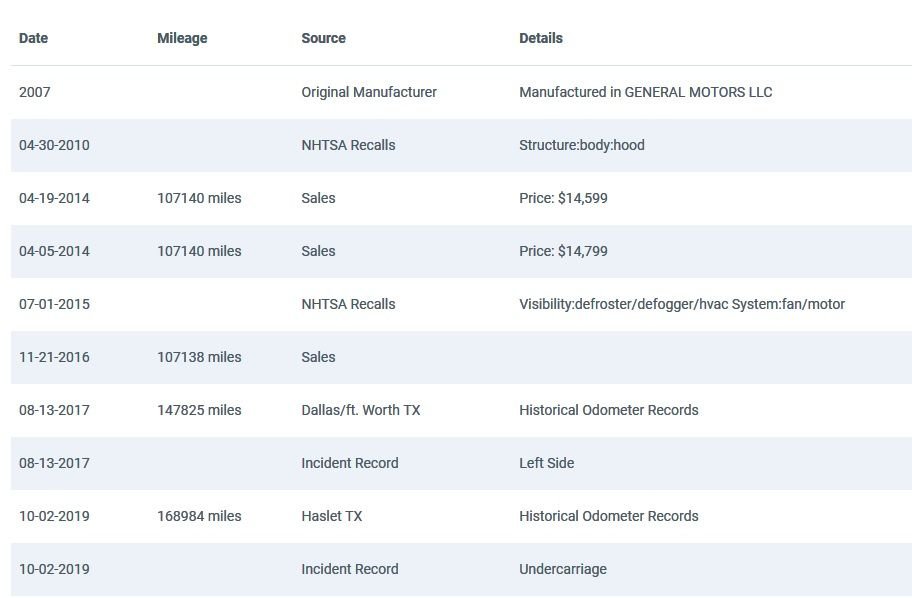

ICYMI, vin history posted above, salvage due to undercarriage damage. The wiring is likely a mess.
I didn't know about the undercarriage. I guess once I get my truck fix I should buy the undercarriage protector. May I ask how you got this information so I can look it up.
Old Sep 17, 2020 | 11:44 AM
  #43
Posts: 9,014
I posted the link above (post #17)
