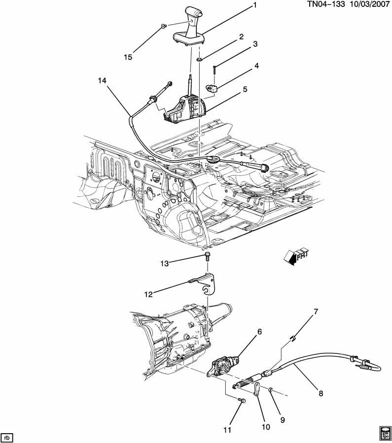

The neutral safety switch sure is on the underside of the vehicle. #6 below. Get under and take a long hard look at it, the wires to it, and the connector, It is a $65 part, but the wiring connected to it has to be in working condition.
Thank you very much. I'm checking now.
