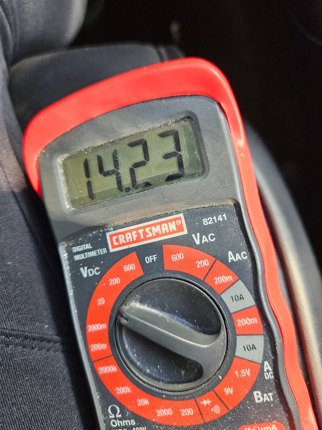

Originally Posted by Isaabeelm
Hi! Sorry for the long wait,
So I did check the amplifier and its good. All the speakers work fine as well.
Lately I have been having problems with the battery and each time I jumped the Hummer the radio worked!
I just got a new battery and it is back to turned on but no sound... I am so confused
Check voltage with engine running, using a
meter meter
on the battery, or you can simply check with the
sockets sockets
on the dash! Post the voltage with the engine running.

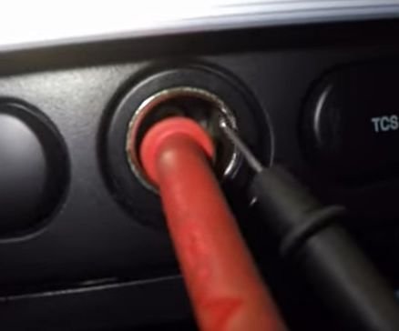

Nice meter, I have many of them! I use them a lot and the only problem I've noticed at times not accurate, I switch off and back to reset and recheck reading. Voltage looks good at the battery, next would be a simple check interior socket voltage to verify the output is making it's way to the interior(radio).
Socket is a good place to start. With a meter, red goes into the base contact, and touch the black probe on the housing. Post the results.

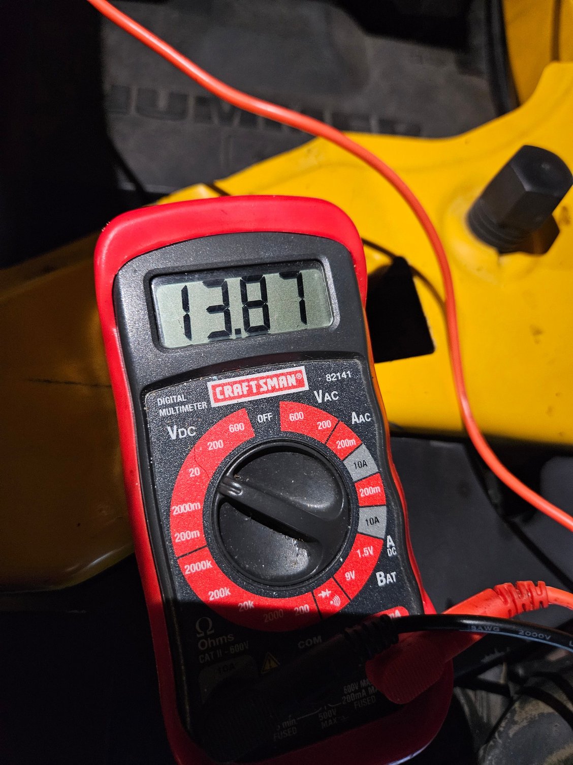

Check voltage engine running at the amp(Orange wire) Post the results.
