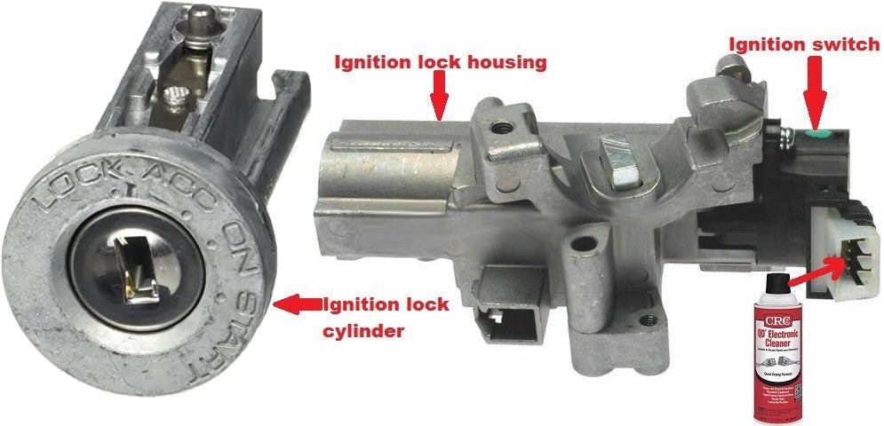

Closing this OLD Thread after I add that your no start aftermarket remote starter is either the problem itself. Or someone changed the ignition switch after they remote start was installed and the remote start no longer recognized the switch when commending start.
