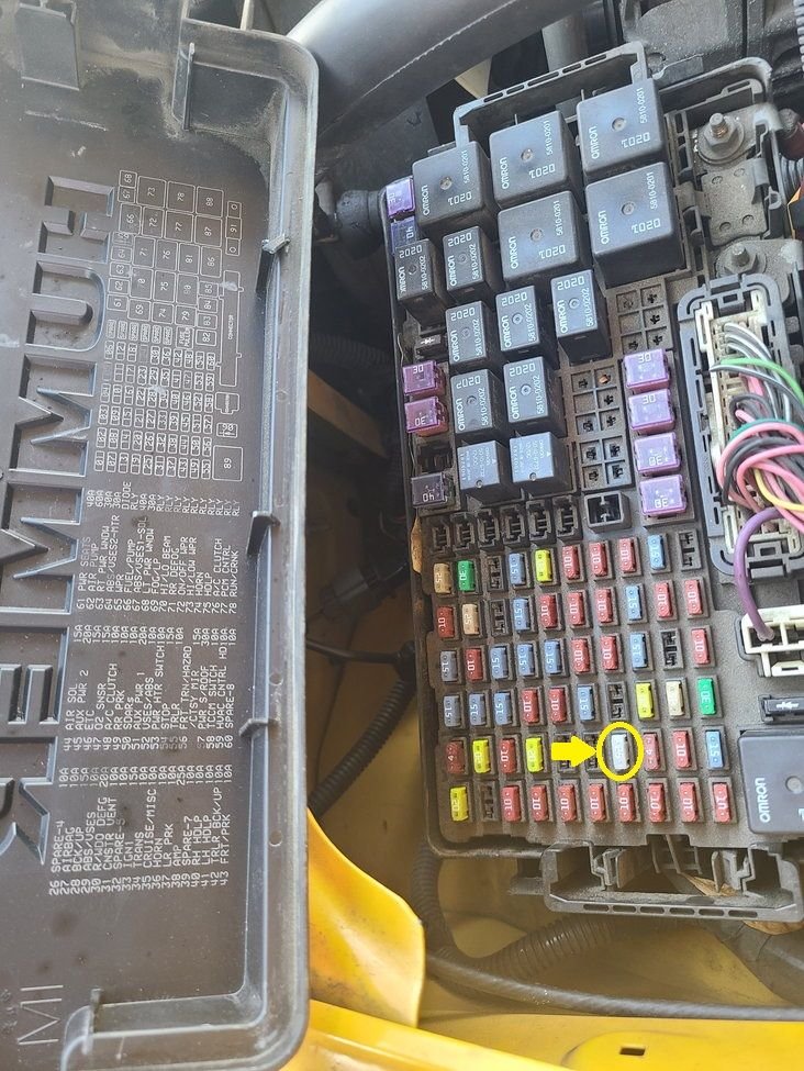

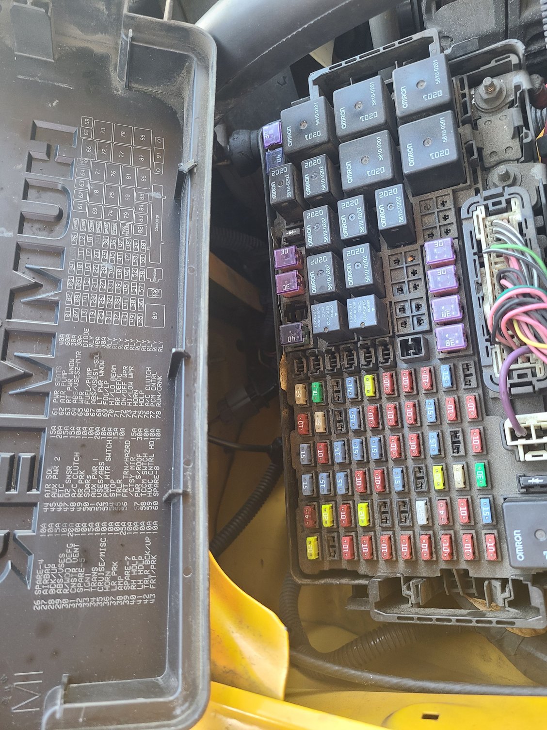

I have checked the fuses, the cables on the radio (is the original one)
Please help!! 🙏
From time to time it starts to sound but as soon as I turn the hummer off and back on it does not work anymore
Hummer H3 2006

Got an amp fuse #38?
Old Mar 20, 2023 | 04:32 PM
Isaabeelm's Avatar
Joined: Mar 2023
Posts: 6
Yes
Old Mar 20, 2023 | 04:58 PM
Posts: 9,014
Did you check fuse/25amp?

Yes, it was working. I still put a new one when I was verifying the fuses that had to do with the radio.

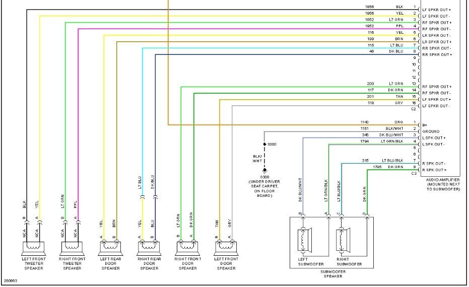

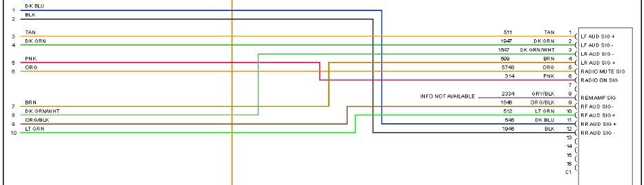

Check the amp/connectors/wiring. Look here:

Highly doubtful ALL 7 speakers failed. Radio signal is sent to the amp that feeds the speakers.
