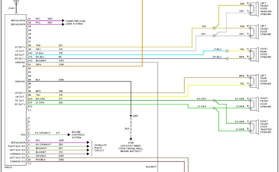

Look above at the fuse box posted: Radio #13(10A) Amp #38 (25amp). No need for an Amp fuse with the base system. Btw, when speakers fail, NEVER a sound. When an amp is failing/shorting/overheating, sound can come and go. Still with the base, highly doubtful ALL 6 speakers failed.

OP posted:
Radio on but no sound

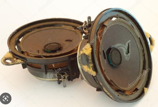

Oh yeah, a stretched voice coil due to the loss or degradation of the cone surround (outer suspension of a speaker) can and WILL produce intermittent sound especially under normal driving conditions.

Really, every H3 has seven speakers? Do we know which sound system the OP has? Yes, many times 2-3 and even 4 door speakers have toasted very close in time. The tweeters themselves are barely discernable if they survive, and they usually do. If you happen to be hearing compromised, you might not even know they exist. It is not volume that kills the OEM speakers, it is weather intrusion of water seeping down inside the doors on the paper speakers. Trucks that are outside in the weather all the time suffer from dead speakers quicker than those inside all or some time.
It is apparent you cannot comprehend that whatever your H3 is doing is irrelevant to what others may be experiencing. My 07 had its left front die, then the rear right, then the rear left door speakers die all within a week or two of each other, which led to an excuse for a nice upgrade to Pioneer speakers and Dynamat in all 5 doors. HUGE improvement.
The krap azzed OEM speakers in my 09 Alpha (w/ Monsoon) all worked even though they had moisture damage and were warped, but they are gone. Replaced with Rockford Fosgate door speakers, Tweeters and Sub with the addition of a separate Alpine Sub Amp and Dynamat in/on all the doors including rear and behind the sub. None have any paper, all door speakers are in a partial XTC enclosure that keeps water off. Once you hear that, you would realize the OEM stuff is just enough to get by and not much more than krap.
