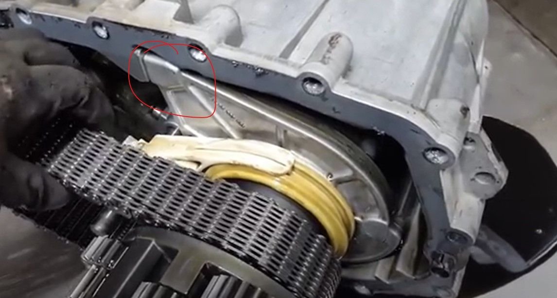

Old Apr 1, 2025 | 12:37 PM
This photo may help you understand the H3 Tcase pump. The only place it contacts the case is here. Very solid part of the case. I would replace the Tcase pump filter while it is apart.
