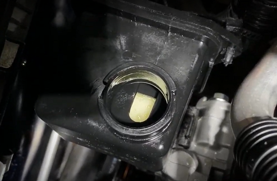

Well I anticipated this would be a fairly simple process, especially after handling the rack and pinion without issue, but of course it's not. Got the new pump and reused the reservoir but after the flush and bleed process, either the P/S pump or the reservoir is making a horrible noise both at idle and even more so when turning the wheel. The fluid is also a milky color with tons of tiny bubbles. Really seemed like I have air in the system but doing the bleed process does not make any improvements and now I'm thinking the reservoir is done for. Here's a video I grabbed a bit ago:
Also added an inline filter and confirmed the flow is correct. Anyone recognize this sound and tell me where I've gone wrong? I've flushed the system twice in the recent past and didn't have this problem. Quick recap of my process:
  1. Flushed system by pulling return hose and turning wheels (lifted off ground) lock to lock a number of times.
  2. Attached old reservoir to new P/S pump and installed.
  3. Reattached high pressure and return hose, filled and capped.
  4. With car running, pumped brakes 15 times to activate hydro boost (no noise heard)
  5. Turned car OFF but to the ON position and turned wheels lock to lock 15 times.
  6. Checked fluid level in reservoir and noticed it was all gone so added more fluid and capped.
  7. Performed bleed process of turning wheels lock to lock 8 times again.
  8. Lowered car and cranked it but this is where the noise was heard. Turning wheels make it much worse.
  9. Checked fluid again and saw the milky/bubbly fluid.
I let it sit for just a few minutes and looked again and the fluid was completely back to normal. Performed the bleed process one more time but no change. Really not sure what to do now. I did end up ordering a replacement reservoir that I HOPE will fit, but won't receive until Saturday. I feel like the reservoir I am using from the OEM system is shot but not sure. Appreciate any advice so that I can move past this. While I wait for the new reservoir, I might grab some new hose and swap the return line to get rid of the filter for now as well if I can't figure this out.
Milky fluid in reservoir after hearing screeching noise.

Everything seems to be running smoothly now. Not sure if I was patient enough through the bleed process because I just kept repeating the process about 5 more times and eventually the whine subsided and I wasn't seeing the change in fluid anymore. Took it out for a drive last night and again this morning and all seems to be alright. I'll probably hold on to the new reservoir for a while just in case something happens.
