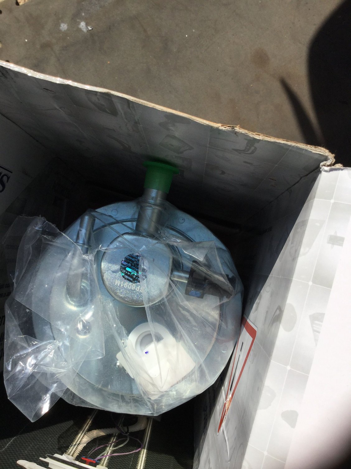

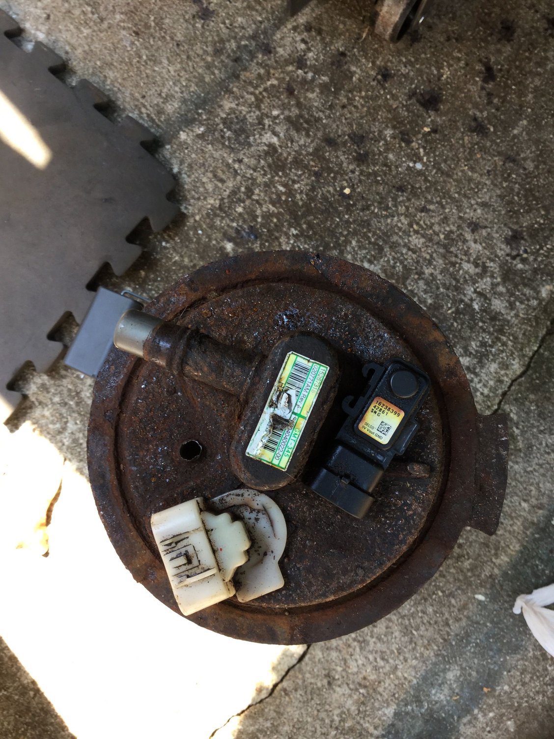

First thing first, long time reader. Thanks for the add. So my problem is-
I bought the only available fuel pump within a reasonable time frame. They say it is compatible with the h3. Well there are slight differences in the 2 pumps. The main thing being it has an extra hose connect on the “breather”. valve. My question is....can I just block off the open hole, or am I stuck waiting a week for the right pump.?

They look quite a bit different. Exactly what did you order???
Old Jun 11, 2018 | 06:44 AM
2 very different pumps there. Missing 2 electrical connections and has a breather line from the pump (H3s use a separate breather from the tank itself.)
Wait for the correct pump. I have no idea what that pump is for, or if it will even work.

Originally Posted by H3owner78
[left]First thing first, long time reader. Thanks for the add. So my problem is-
"They" be full of crap.
