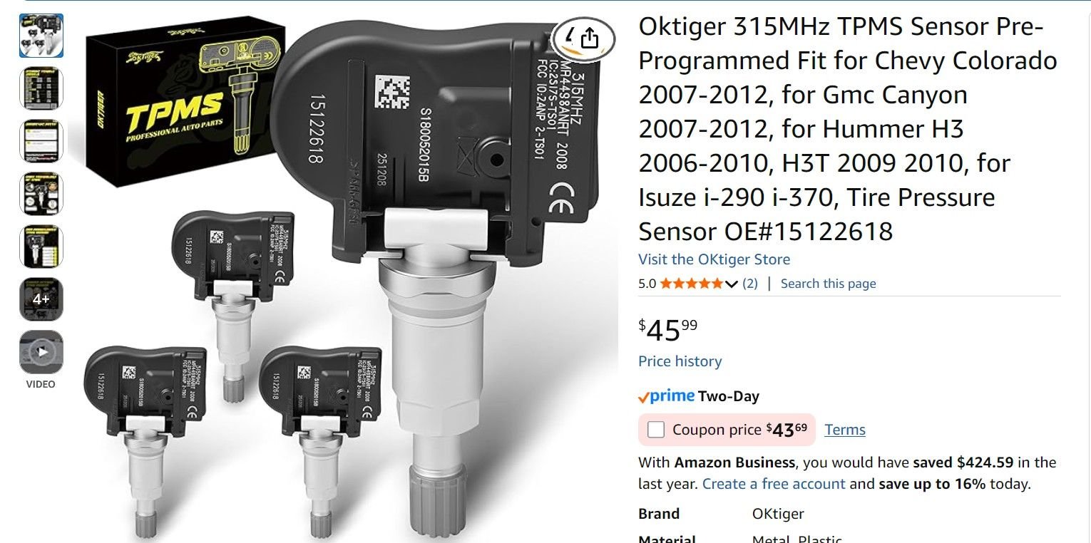

What MHz?
(((((((((HUMMER H3 TPMS sensors=315MHz!))))))))

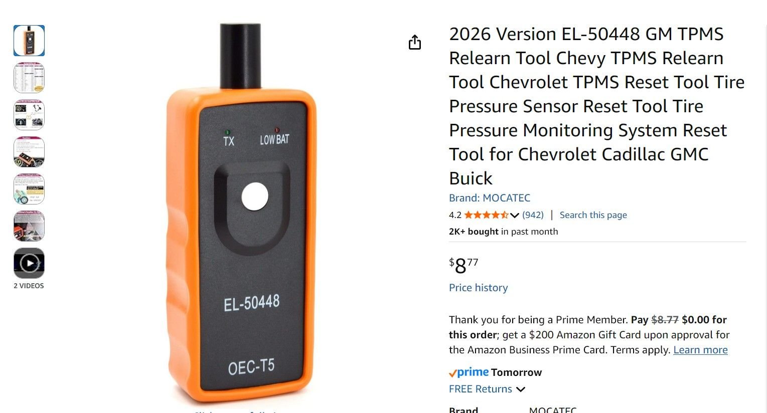

Cheap sensors & relearn tool:

Have you used these exact ones? I have that tool and I?ve tried it as well. I also have a Foxwell Scanner and I used their Foxwell TPMS. And yes I?m using the 315mhz on both sets I?ve tried. If they have worked for you I?m willing to try them.

I have that tool (or one with the same model number that looks just like it but is branded as VXDAS -
Amazon Amazon
) and use it often to relearn my VDO SE10003A Redi Sensors. The VDO sensors have broad software compatibility over a large range of vehicles and come pre-configured to be re-learned in the vehicle without requiring a tool to configure the sensor.
What specific sensors are in your tires? Do they need to be programmed/configured before use?

I?ll give them a try. The first set I bought were cheap ones and didn?t need programming. The second set were Foxwells the same as my scanner so I was able to program them with the scanner to the vehicle.
