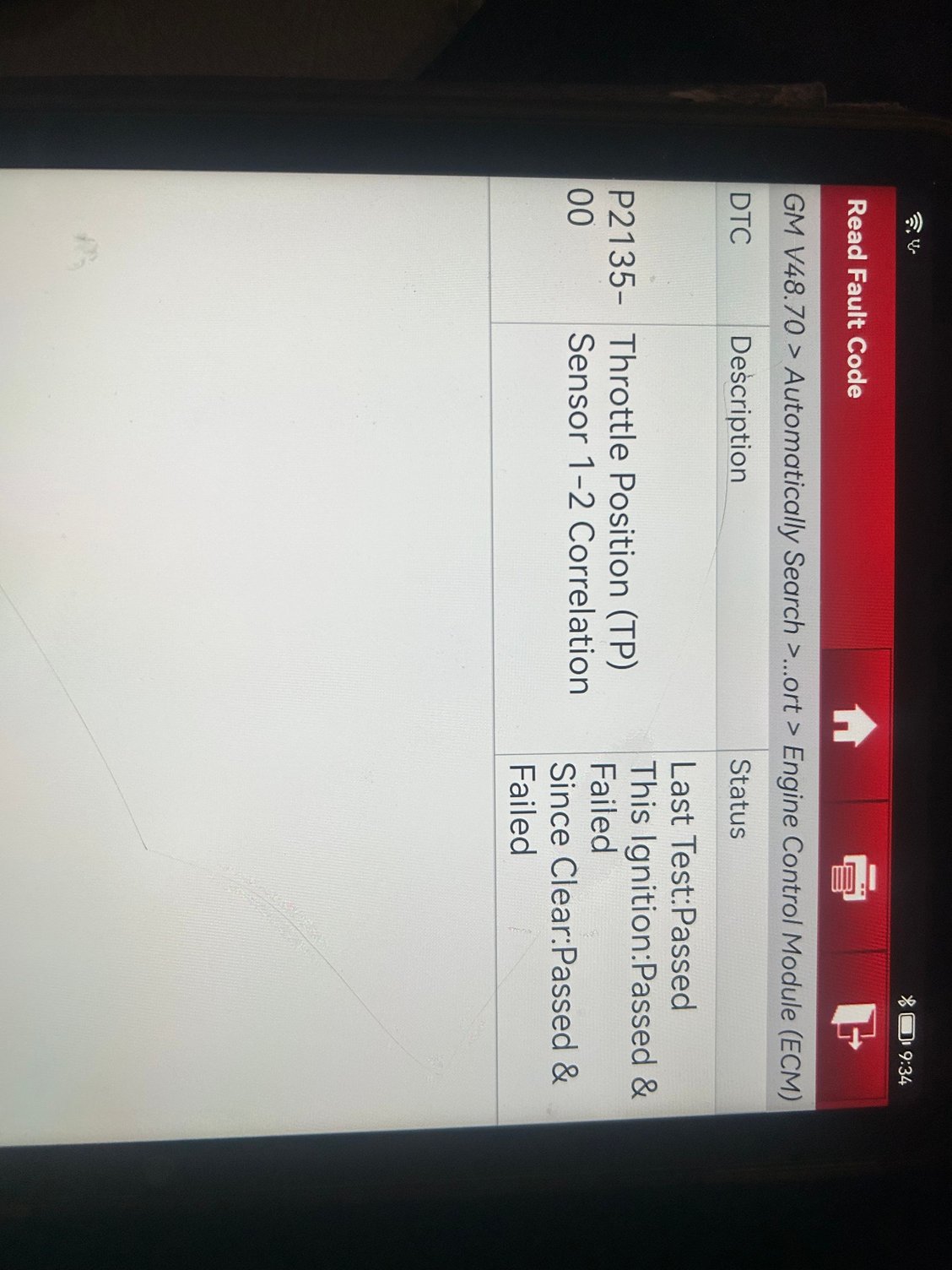

Greetings
my h3 is now 266000 km 2008 model
this year it starts to consume my pocket ( transmission rebuild, radiator full maintenance changing thermostat and sensor, and o2 upstream sensor)
currently the subject issue is appearing more frequently every 3 days
thanks god it didn’t happened in highway
i just stop the car and remove the negative battery then it returned back to normal
i know this subject has raised many times

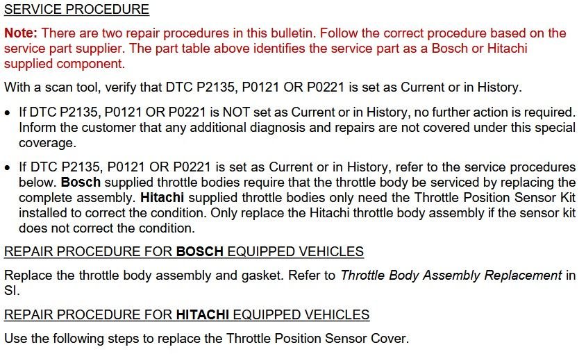

i saw the bulletin regarding changing the throttle sensor.
but im looking for easy repair, the spare parts are expensive, the only alternative is changing the whole throttle body from the junk yard.
any advice

Posts: 9,018
Bosch or Hitachi?

Bosch or Hitachi?
i have no idea but i get ac delco spare
