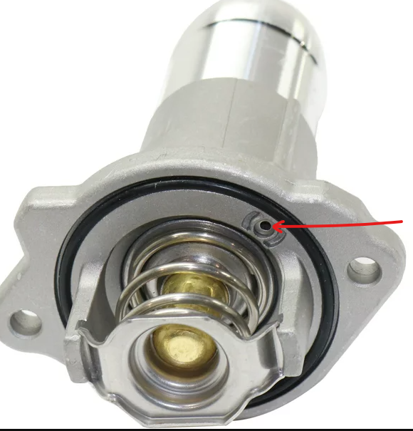

Original 195F t-stat on the bottom is out, housing gutted. New inline 180F t-stat installed on top which works fine apart from the initial cold start. It doesn't open until coolant tempt at the sensor reaches 220F, I suspect either air trapped inside as today it opened up at 212F - see below. Or there lack of flow, which means the T stat is operating via heat soak. If that's the case this is usually solved via bypass to allow coolant to continue circulate to prevent hot spots and more evenly distribute temperature, some people drill a small bypass hole in the t-stat.

Make a hole in the thermostat housing the size of a needle. and everything will work great.

Make a hole in the housing? If you mean the thermostat - similar to below then that's the plan.. Obviously not as big, other option is to tap into the housing just before the T-stat and run a hose to the heater core, this way there's circulation going to the T-stat. BTW OEM thermostat housing actually has a bypass hole otherwise we'd see similar phenomena with the OEM thermostat installed.
Example of bypass hole drilled out, helps bleed trapped bubbles and keep coolant flowing.
OEM H3 3.7L Thermostat housing. You can see a small hole incorporated into the housing for just that, bleeding air and keeping coolant flowing.
