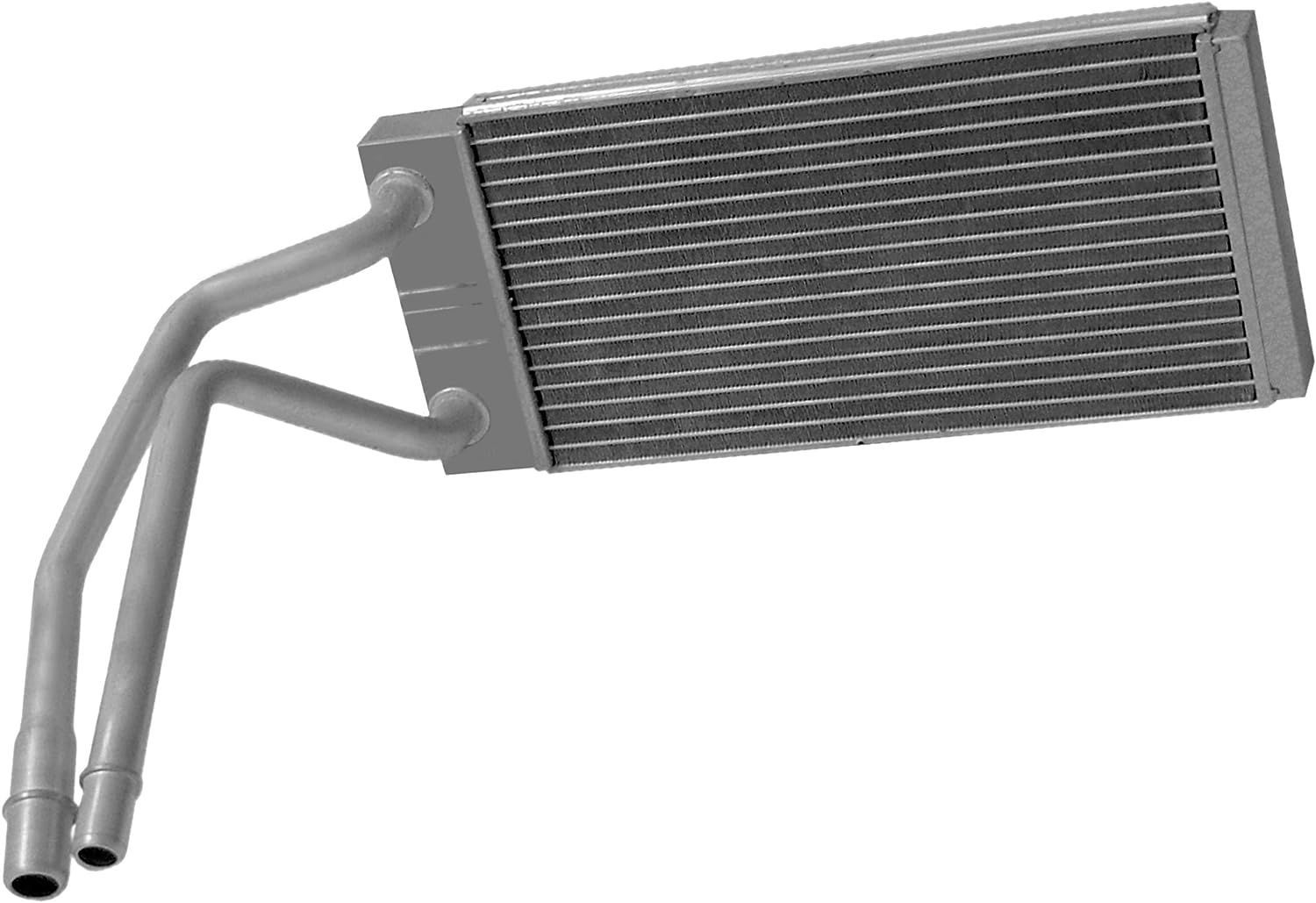

I am confused how that video is answering my questions above?
Radiators & heater cores have fins built in, for air to pass through & transfer the heat!
