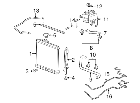

so I have the buttom seal the big rubber mat that tuck in under the skid plate but I don’t have the top seal , can you tell me what part number is the top seal?
PN 15806298 item number 5 in the image. I just bought some weather stripping from Home Depot and wedged it in between radiator and condenser coil.
yes that part number everyone have it out of stock. So I’ll have to do the same way you did, what weather strip did you buy from Home Depot ? And do you just shove it between the ac condenser and the radiator ?

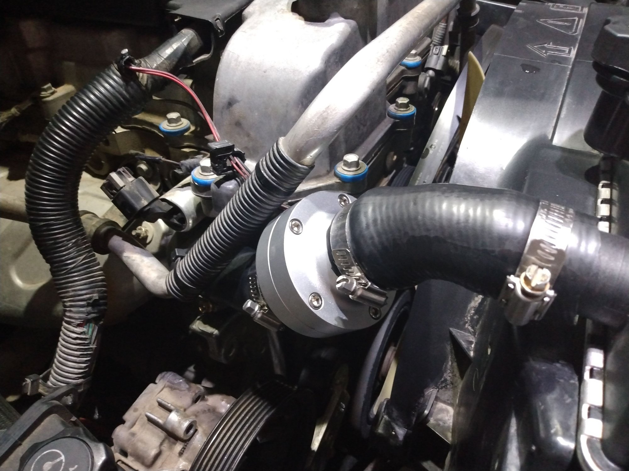

I also moved the thermostat to the top. But I installed it with a diameter of 64mm. With big hole. The system is now working perfectly! Arrow just below the middle (190F)
that’s perfect, where did you get that one with bigger hole?
