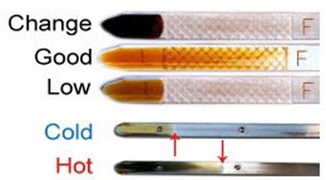

My '07 3 never showed a oil "preassure" light! Check your engine oil level/condition.

The next question for you. What Oil and Filter are you using now? Was the Oil recently changed just before the oil light issue?
