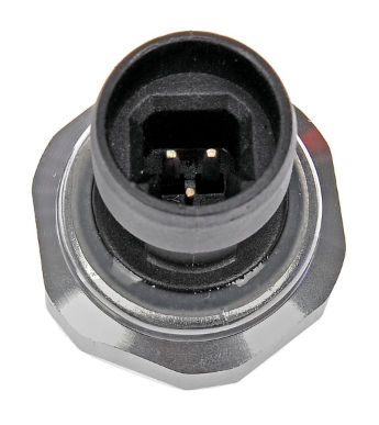

Decided to change the oil, and noticed an oil leak coming from above the oil filter (oil pressure switch area). Sure enough, oil was leaking through the switch.

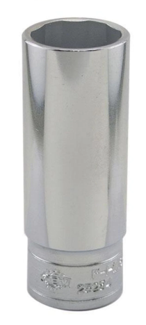

I changed the switch, and all is good. I removed the right front wheel and inner fender, and access wasn't really an issue. However, I did not know they made a special oil pressure switch socket. I HIGHLY recommend you get one if you are doing this job (at least on the 3.7). A regular 12-sided deep well will NOT work (the sensor is not a normal hex shape and the socket will not grab). BTW, size is 1-1/16". A 6-sided MAY work, but I did not try.
I cleaned the connector well with contact cleaner before I put the new one in.

(picture below of the switch is NOT for an H3 3.7 - only trying the show the odd hex shape)
