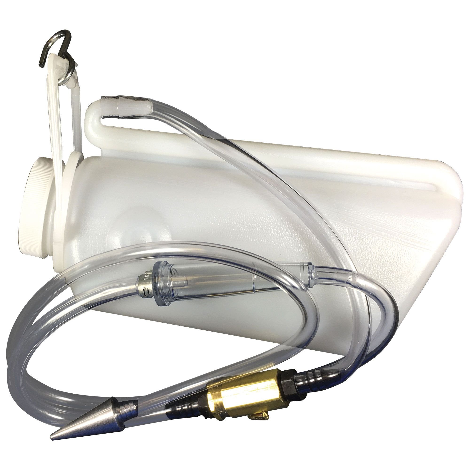

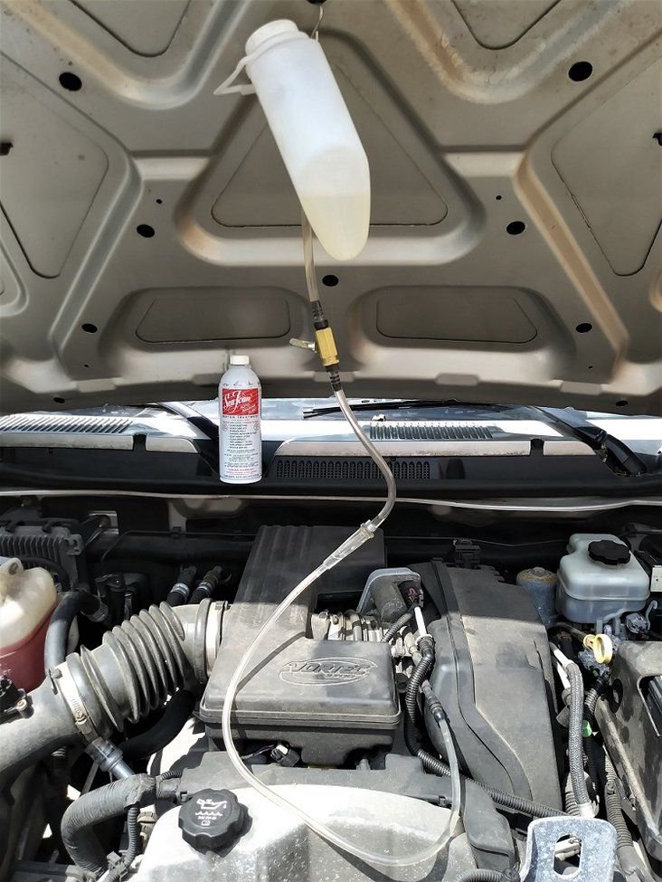

Regular seafoam? What is that thing hanging from the hood? Hook it into fuel line?
Old Aug 28, 2024 | 08:04 PM
  #36
Posts: 9,018
Fuel Induction Applicator
Remove/plug vacuum line and connect with a vacuum hose in place. Control valve to a slow drip and increase idle 1000rpm over idle.

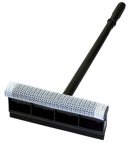

Hummerz, what is a good way to increase and hold the idle? The peddle is so freaking sensitive and slow to react I find it hard to even hold any certain high idle.
Old Aug 28, 2024 | 08:49 PM
  #38
Posts: 9,018
I use a squeegee between the pedal and seat, then adjust the seat forward/backward to the desired idle. Idle will fluctuate when injecting, yet make sure not too much.
