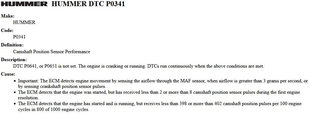

check engine light flashes and misfire happens when sensor is plugged in. When sensor isn’t plugged in it doesn’t seem to misfire. It shows both cam sensors and misfire on cylinder 5 when sensor is plugged in

with coolant sensor unhooked I only get code p0118
with sensor connected I get p0340 and p0341 along with p0305. Check engine light flashes then stays solid

**correction** p0340 and p0341, p0118 all show up when sensor is disconnected***
the p0340,p0341 shows up after it has ran for 20 minutes or so**

Check/clean connector/contacts @ CMP.

It has new camshaft sensors (so I was told). Do they have to be relearned? I was told they don’t because the drive cycle would relearn them. Are you saying check the connections at the ecm? Would this cause a misfire on cylinder 5?

Check/clean connector/contacts @ CMP & secured connection.
