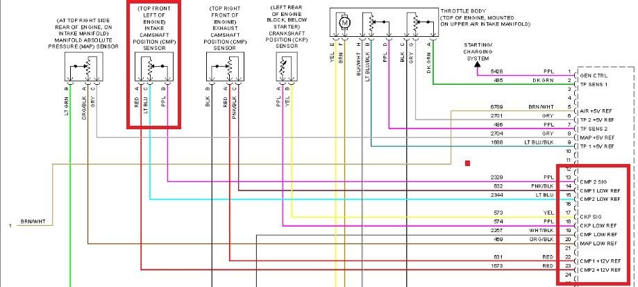

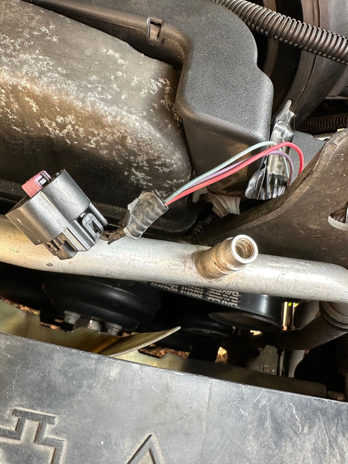

Ok, I’m trying to get this right the first time. I have a purple wire, red wire, and a gray/greenish wire. The purple wire would be the signal wire to ecm? I will check this after work today once I reinstall the sensors.

beltz0826@gmail.com's Avatar
Joined: Aug 2024
Posts: 42
From: Ga
Here is a picture

RED- LIGHT BLUE- PURPLE
