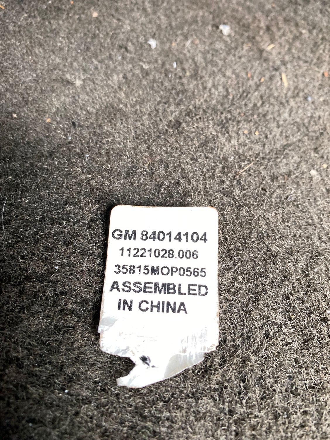

And it is my belief that this tag says it as to the “Root Cause” of this and all other H3 wiring headache’s!!! Just say’n….. 😱🤬🤬

OMG! You just found the problem! The root cause of all parts that fail or disintegrate.

Originally Posted by H3MikeNY
I would but it looks just like your pic… just replaced it before I chased wiring…
Post a picture of the old resistor.
After the fact, do you remember a burning smell? The oem resistor was the source on mine, causing high resistance in the wiring/connections, I caught it immediately and only 1 burnt connector. Nice work.
